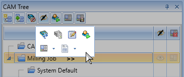

CAM Tree
- Enable CAM Tree Flyouts - The CAM Tree Flyouts appear as the '>>' symbols next to items in the CAM Tree. These allow you to double check some, and even edit other values by simply clicking on them in the CAM Tree.
Select the check box to show, and be able to utilize, the CAM Tree Flyouts.
Clear the check box to hide the CAM Tree Flyouts. - Auto Blank New Items - Determines the Blank/Unblank state of newly created features and their operations. By default toolpath is shown until it is hidden by the user. Using this option will reverse that and the toolpath will be hidden until the user clicks an operation in the CAM Tree, or unblanks the toolpath.
Select the check box to have the toolpath of newly created features hidden.
Clear the check box to have the toolpath of newly created features shown.

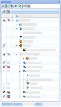

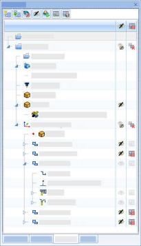

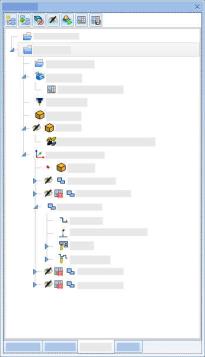

Look and Feel
- Style - allows you to adjust whether the Blank/Unblank and Post Yes/No states are accessed through the context menu only (Classic), or whether they are shown in columns in the CAM Tree and used as toggles (Extended).
| Classic | Extended |
- Status Location - allows you to adjust whether the Blank/Unblank and Post Yes/No toggles are located on the left or right side of the CAM Tree.
| Left | Right |
Tip: See the Status Style States topic to get more information.
