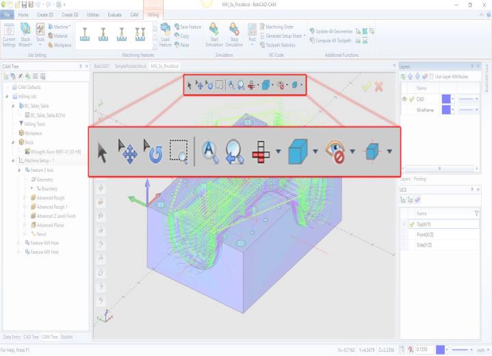

The Document Toolbar
This topic will describe the document toolbar, and explain the options found in it.
Document Toolbar
The Document Toolbar allows you to have the view options for the graphics area available to you no matter what ribbon is currently in use.
The Document Toolbar options

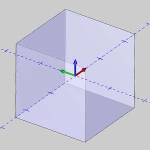

Transparent
- The Transparent function is used to make solids/surfaces in
the graphics area appear transparent (or see through). To perform
the function, you click Transparent.
To return to the
default view, click Transparent again.
View
an example

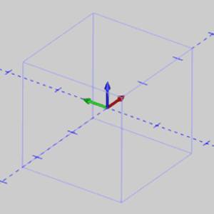

Wireframe -
The Wireframe View command shows and hides the interior lines
of surfaces and solids. -

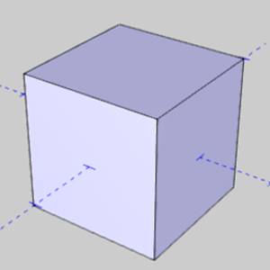

Ortho Projection - The
Ortho Projection function is used to change the view in the graphics
area between the default perspective view and an orthogonal view. To perform the function, you
click Ortho Projection; to return to the default view, click Ortho
Projection a second time.

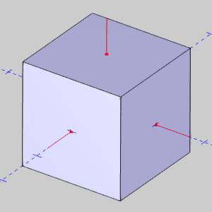

Surface Normal - The Surface Normal function is used to
show or hide the surface normals of solids/surfaces in the graphics
area. This indicates the outward (positive) direction of solids/surfaces.
This function is important for creating Multiaxis features. The Reverse Surface Normal Function.

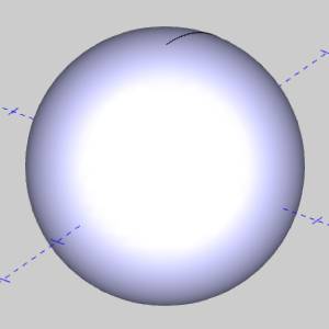

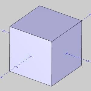

Shaded
Smooth - The Shading Smooth function is used to smooth
the appearance of solids/surfaces in the graphics area. This is
turned on by default. To turn the function off, click Shading
Smooth. To return to the
default view, click Shading Smooth again.
View
an example

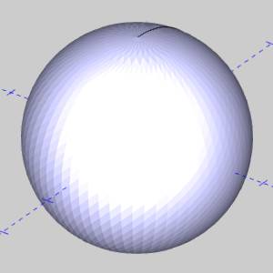

Polygon
Shaded - The Polygon Shaded function is the default view
used for solid/surface entities. They appear as a shaded solid/surface.
The Polygon Lines function is used to change this view to a triangle
mesh.
View
an example

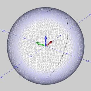

Polygon
Lines - The Polygon Lines function is used to show the
triangle mesh of solid/surface entities in the graphics area.
When you click Polygon Lines, the view of the solid is updated.
To return to the shaded view, click Polygon Shaded.
View
an example
