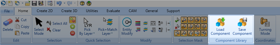

Component Library: Save, Reuse, and Speed Up Your CAD Workflow
Design smarter with the new Component Library, now available right on the "Home" tab. This powerful feature lets you easily save and reuse your own custom 2D or 3D geometry — helping you work faster and more consistently across projects.
With the Load Component tool, you can search through your library, preview your saved models, and drop them right into your workspace — complete with options to scale, rotate, and mirror as needed. You can even browse and load supported BobCAD file types from any folder, giving you complete flexibility.
Creating reusable components is just as simple. Select geometry from the graphics area, use Save Component to name and describe it, and it’s ready to go for future projects. Saved components use the new .bbcdx format — a universal BobCAD format that works across multiple product lines.
Whether you’re building your own library of go-to parts or pulling in models from your file system, the Component Library helps you save time, standardize designs, and boost productivity.

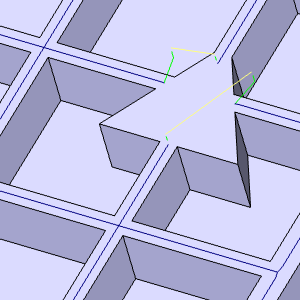

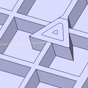

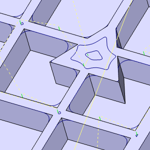

In Mill 2-Axis, you now have full control over your cut depths with the brand-new "Customized Depths" option. Rather than sticking to uniform depths, you can manually define each step exactly how you want it — perfect for using larger depths at the top of the profile and smaller depths at the bottom for precision control.
For Mill 3-Axis, Setting up Boundary constraints for the Operations just got a lot easier! The all-new "Boundary Options - Trimming Criteria" gives you a smarter, more accurate way to define machining areas. With the options of "Tool Tip Point" (Old Method) or "Tool Contact Point", you are able to easily cut along 3D surfaces in any X, Y, or Z direction. Instead of manually calculating and adjusting the boundary to where the tool hits, just let the system calculate it for you. The result? Your toolpath follows the actual contact point of the tool rather than over or under traveling, making setup faster and avoiding edge violations.
You’ll also see major gains in the Flatlands Operation, now upgraded with features like optimal XY machining angle, multi-pass depth control, and even an automatic single-pass strategy for thin areas. Combined with a smarter outside-in cutting order, these changes improve surface finish, tool life, and programming efficiency across the board.
And for those working in 4-axis, the Advanced Finish operation just got a big boost with a new "Along Tool Axis" lead-in/out option. This gives you more control over how your tool enters and exits locking the tool orientation to the rotary axis, especially in complex geometries — reducing marks and improving part quality.

The NEW Component Library
BobCAD-CAM V38 introduces the all new Component Library! This new library introduces the ability for users to setup and define a library of their own CAD geometries. There are two functions to Load and Save geometry into the Component Library: Load Component, Save Component found on the "Home" tab in the top ribbon. You can now store common geometries that you use all the time and access them quickly. The Component Library functions allow you to save or bring in geometries (also called, "components") from the current file you have opened. Browse the library, see a preview, see title and description, and load in the components using all the familiar transform functions that you know and love such as set origin location, scale, mirror, and rotate.
Additionally, as you are saving/loading the components, you have the ability to choose from "Save/Load Component" or "Save/Load to File".
  • The "Save/Load Component" button, you are using the Component Library file directory built into BobCAD-CAM found here: C:\BobCAD-CAM Data\BobCAD-CAM V38\Component Library with the advantage of being able to use the Migration tool to bring the library over to new or other BobCAD-CAM software.
  • The "Save/Load to File" button, pulls up a file explorer and allows you to store your library anywhere on your computer if you have our own file directory that you want to store the components in.
Save Component
The Save Component function found on the "Home" tab allows you to save any piece of geometry in the current document into the Component Library. Simply click "Save Component", select your geometry in the graphics area, setup a desired name and description and hit, "Save Component" or "Save to file". If "Save Component" is selected, a new dialog will pop up shown below where you can define where specifically you want to save the component in the library. If "Save to file" is selected, it will load a file explorer where you can pick the location of where you want to save the component on your computer. Once saved, a bbcdx file (a universal BobCAD format that works across multiple product lines) will be saved to the location set by the user.
Initial Save Component Dialog
These are the options from top to bottom:
  • Component Description - A multi-line text field that allows you to setup a description of the component
  • Component Name - The name of the component that shows up when searching through the library. Note: This will be the .bbcdx file name which follows the same rule of standard file names in Windows. You can not use the following characters: \ / : * ? " < > |
  • Selected Geometry - While this box is active, select geometry in the graphics area and this box will populate with all the geometry to save
  • Save Component - loads the "Save Component" dialog below. If you want to save the components in the built-in library, click this button
  • Save to File - loads a Windows File Explorer to save the component to your own file directory. If you want to save the components to an external folder location, click the button.
  • Cancel - Click this button to cancel out of the function without saving anything
Save Component Button Dialog
  • Component Description - Retains the description set in the previous dialog, but allows you to update on the dialog if needed
  • Component Name - Retains the name set in the previous dialog, but allows you to update on the dialog if needed
  • New Component Group - Create a new folder to save the component into
  • Delete - Deletes the selected item in the tree
  • Rename - Rename the currently selected Component or Component Group
  • Component Library Folder - The root directory where all the components are stored inside of
  • Save - Saves the current component
  • Cancel - Cancel out of the function without saving anything
Load Component
The Load Component function found on the "Home" tab allows you to load any piece of geometry into the current document from the Component Library. Simply click "Load Component", select the component from the "Load Component" or "Load File" button, and place the component into the graphics area by using the "Location and Size" and "Orientation" sections to adjust the component and/or click inside the graphics area to place it manually. Then, click "OK" at the bottom to confirm it.
Load Component Setup Dialog
These are the sections from top to bottom:
  • Load Component - Opens the "Load Component" dialog. Click this button if you are loading in a component directly from the built-in Component Library
  • Load File - loads a Windows File Explorer to load the component from your own file directory. If you want to load in components from an external folder location, click the button.
  • Component Name / Description - Once a component is selected, the Name and Description will show up here
  • Origin - Allows you to set the origin inside the graphics area. the X, Y, and Z fields move the whole component and position the origin in the location. To adjust the location of the origin point (In relation to the component), Use the drop-down box to select from: Center, Bottom Left, Bottom Center, Bottom Right, Right Center, Top Right, Top Center, Top Left, Left Center. Note: If you need to set the Origin to a custom specific location, follow the steps below under "Custom Place the Component into the Graphics Area".
  • Scale Factors - Scale the component in the XYZ direction
  • Rotation Angle Around Axis - Rotates the component around the Z, X, and/or Y directions relative to the component origin
  • Mirror - Mirror the component about the Y-Z Plane, X-Z Plane, or X-Y Plane relative to the component origin
  • OK - Click OK to execute the placement of the component
  • Cancel - Cancel out of the function without placing the component into the graphics area
Load Component Button Dialog
  • Open - Click OK to confirm the currently selected component
Custom Place the Component into the Graphics Area:
It is also possible to place the origin in a specific user-defined location other than the options shown in the Origin section. This can be done by first placing the component into the graphics area by left-clicking. Then, hoover your cursor over the desired area you want to place the origin and click on a snap point that shows up. Note: You need some sort of reference geometry in the graphics area to select. You should now be able to drag the component freely around the graphics area. Now, you can simply click again to place the component in the desired location.
You can also use the Migration Tool (File > Migration) to bring this Component Library over to other BobCAD-CAM software or computers.

Flatlands
Additional Depths
The Flatlands operation now includes an Additional Depths option, designed to improve control when machining thicker stock. Instead of cutting flat areas in a single pass, users can now divide the motion into multiple depth steps for more efficient and safer roughing. This group includes options to define a consistent Depth Step, set a specific Number of Passes, and an option to enable a Final Depth Step to apply a lighter finishing cut at the bottom. These enhancements give users greater flexibility when managing material removal and tool load on flat regions.
Single Cut for Thin Areas
Single Cut for Thin Areas improves toolpath efficiency by applying an optimized algorithm that reduces travel, especially in tight regions where multiple offset passes aren’t needed. This checkbox enables a streamlined approach in areas smaller than the tool diameter, offering three targeted options—Narrow, Wide, and Narrow and Wide. The Narrow option traces along tight regions with a single pass, Wide skips unnecessary cuts and applies shaped offsets to broader areas, and Narrow and Wide combines both strategies. This added control leads to cleaner, faster results in challenging flatland geometry.
Previous AlgorithmNarrowWideNarrow and Wide
Optimal Machining Angle
The Flatlands strategy now includes Optimal XY Angle, a powerful toolpath enhancement originally introduced in Planar. This feature intelligently aligns parallel passes with the longest dimension of each machined area, optimizing cut direction for improved efficiency and surface quality. By allowing independent angle adjustments across different regions, it maximizes material removal and minimizes air cutting—bringing smarter, faster machining to flat features with complex shapes.
Outside-in Ordering Enhancements
Flatland toolpaths now benefit from an automatic outside-in ordering strategy that optimizes pass direction without requiring user input. By starting from the outer edges and working inward, this improvement reduces top-down engagement on the material surface—resulting in better surface quality and significantly extended tool life. This behind-the-scenes enhancement delivers smarter motion for cleaner, more efficient flatland machining.
