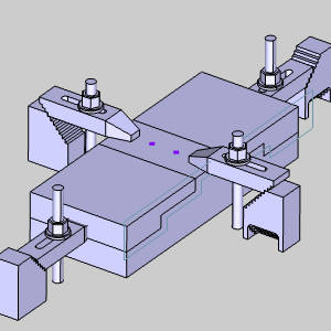

In this example we have a bunch of entities in the graphics area with only basic layer separation. We do have our points, profile, and solids separated by layer, but with group folders available, we can organize this much better to make any work we're doing a lot easier. In the graphics area, we currently we have:
Profile
- Points for:
Two different hole sizes
One tap size
One counterbore size
Solids:
Fixtures for:
First job
Second job
Stock
Workpiece
We can use the same logic seen in these bullet points to build our layers and group folders!
