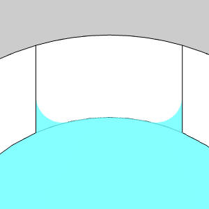

Cutting this geometry with the regular pocket toolpath will leave burrs along the open edge, and left over stock from the tool radius between the walls and open edge.

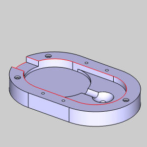

Note: If our model contained the flat surface seen in the last of the above images, we could simply select that as our geometry. Since it does not, our first step is to create the geometry needed to machine the desired feature.

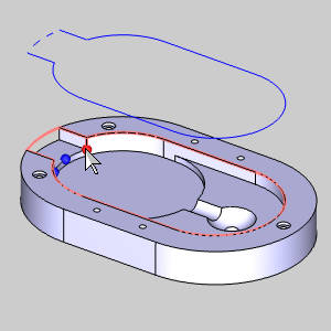

In the Utilities group, of the Create 2D ribbon, click
Extract Edges.

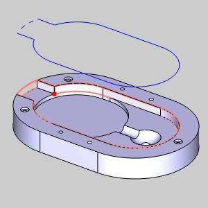

The Extract Edges dialog appears. -

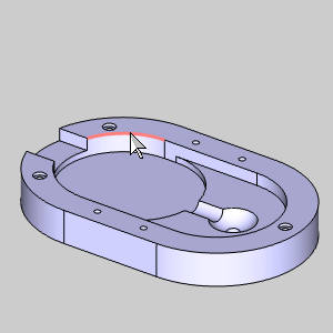

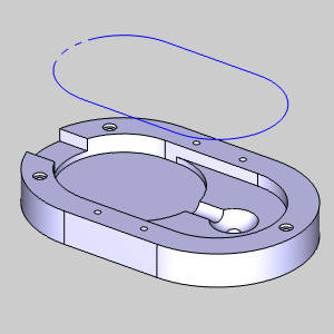

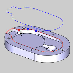

Begin selecting the top inside edge of the part going around to include the two top edges of the slot, and its outer-most edge.
Note: We do not include vertical lines in the selection because 2 Axis geometry selection is projected flat in the background.

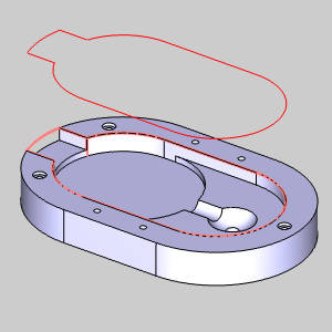

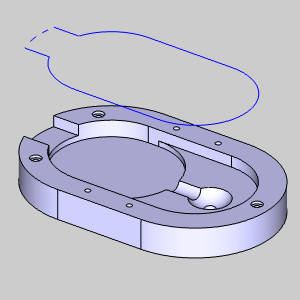

Select the check box for Project to Z Plane, and choose a height above the part so our part does not interfere with the selection of the wireframe geometry we create.
Click OK.
The geometry is created and projected to height. -

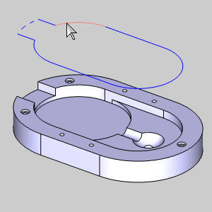

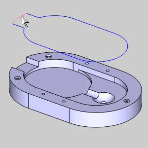

Enter selection mode and select the outer arc of our slot.
Right-click in the graphics area and choose Modify Attributes > Line Style.
Select any of the dashed/dotted lines to represent the open area of the pocket, and click OK.
The line style is updated.

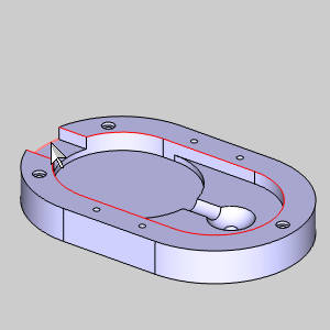

Highlight one of the entities of our extracted geometry, hold shift and click to chain select the entire chain.
The Geometry is added to the Selected Geometry list and the feature preview appears.

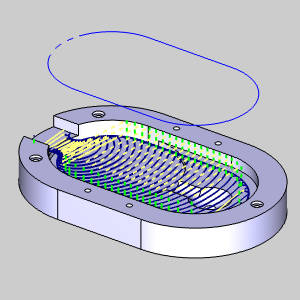

Currently, this is not the result we are looking for.
Part 4) Choosing the Advanced Pocket Pattern
With the Standard Pocket pattern we first used, open pockets are not possible and we are left with the burred edge and tool radius in the corners we saw in the image of the simulated result. Now, we update the pattern to utilize the Advanced Pocket.
Edit the feature by double-clicking it.
The Mill 2 Axis Wizard opens. -
Click Patterns to move to the Patterns page.
In the Patterns group, select Advanced Pocket.
Click Compute.

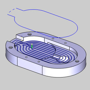

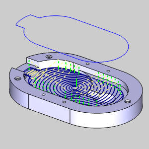

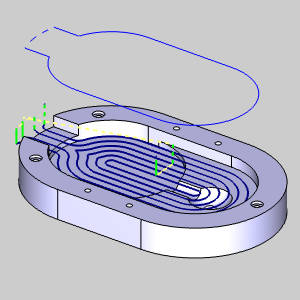

Notice with the same geometry selected, the operation now handles the dotted line differently than the other entities. This is the power of using the Advanced Pocket to create your open pockets. -

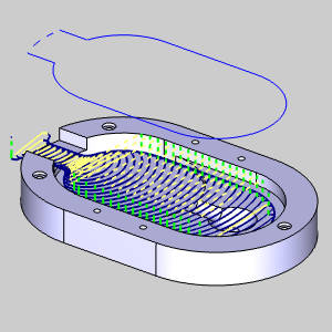

Edit the feature once more, change the Pattern to Adaptive Roughing, and click Compute.
Although each of the Advanced Pocket patterns will handle the dotted line the same, the Adaptive Roughing provides the high speed milling result which is so effective for material removal.

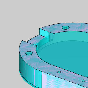

Let's assume for a moment you have an open area next to walls. Notice the stock we are beginning with in the images below.

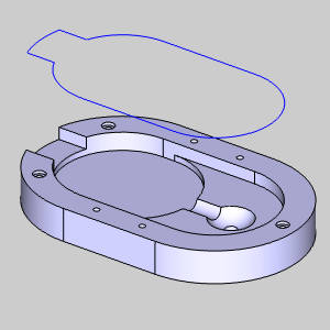

With most of the stock already gone, it may seem as though we should update our geometry to something similar to the image below to limit where our open edge is.
Update the feature geometry and compute.
At first glance, this may seem perfect. However: -

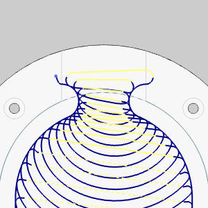

Set the graphics area to a top view, and set the solid to a transparent view.
This is where you'll want to use caution when programming open edges.
Notice the way the toolpath rolls out of the open edge and into our walls. This is always the behavior or open pocket toolpath and should be kept in mind.
For this situation, we may want to use the original open pocket geometry. Or, if we are trying to minimize unnecessary moves as much as possible, add offset arc just beyond the tool diameter and handle it as a closed pocket as seen below.
