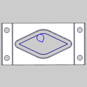

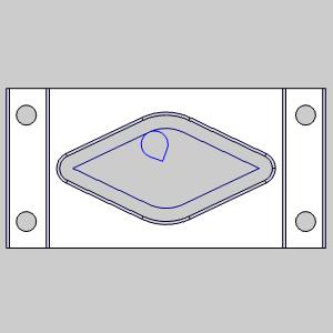

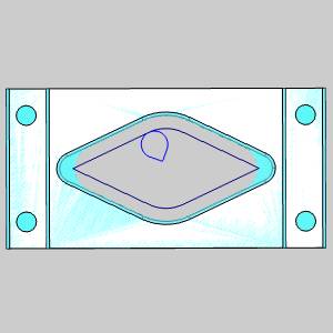

Take a moment to look at the stock compared to the existing toolpath to see the what we intend to accomplish.
In the CAM Tree, click
Stockto view the assigned stock.
Take a moment to look at the existing stock compared to the existing toolpath to get an idea of where we would like to break our toolpath elements.
In the CAM Tree, click the Pocket operation in the feature to remove focus on the stock and to place focus on the toolpath to be adjusted.

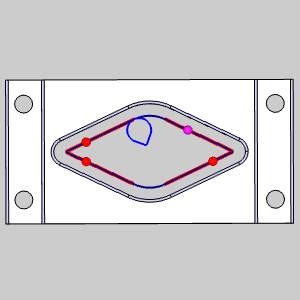

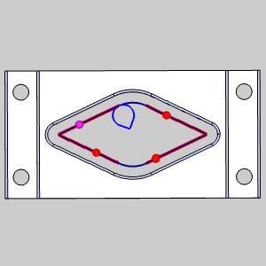

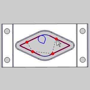

Part 5) Selecting Toolpath Elements

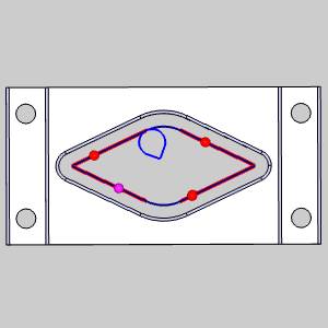

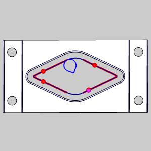

In the graphics area, select the toolpath shown in the images below.
Notice that as the points are selected, and are added to the Screen Point list, the associated toolpath elements are added to the Selected Toolpath list automatically.

With the toolpath elements selected, we will need to define the distance of the Break Point.
In the Break Point list, select Break Point - 1.
Break Point - 1 highlights in the graphics area.
Change the Distanceto 70.
In the Break Point list, Select Break Point - 2.
Break Point -1 adjusts its position in the graphics area and BreakPoint - 2 highlights.
Change the Distanceto 30.
In the Break Point list, Select Break Point - 3.
Break Point -2 adjusts its position in the graphics area and BreakPoint - 3 highlights.
In the Break Point list, Select Break Point - 4.
Break Point -3 adjusts its position in the graphics area and BreakPoint - 4 highlights.
Part 7) Executing the Action
Click Execute.
Break Point -4 adjusts its position in the graphics area, and the toolpath elements update.
