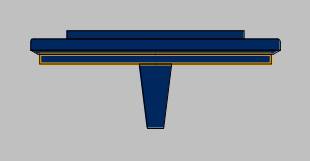

Part 3) How to Create a Tool Holder
To define the first element, in the Element List, click Cylinder.
In the Element Parameters list, type the following values.
To define the next element, in the Element List group, click Add Cylinder, and type the following values.
Be sure to click the arrow next to Top Chamfer, and then click Top Fillet.
Click Add Cone, and type the following values.
Click Add Cone.
After adding this cone, you realize that a cylinder is needed before the cone.
Instead of deleting the cone, click Add Cylinder.
To reorder the elements, click Move Up.
With the cylinderselected, type the following values.
In the Element List,select the cone that was previously added, and type the following values.
Click Add Cylinder,and type the following values.
To finalize the new tool holder, click OK.
In the Milling Tool Holder Library, notice that the new Tool Holder Category (My Holder 1) displays on the left side.
This now completes the process of making a Tool Holder and category. The geometry only includes the portion of the tool holder that is exposed from the spindle down to the bottom of the V-flange. The rest of the tool holder, below the V-flange, is classified as the tool arbor. The tool arbor is created next.
Tip: The center section (V-flange) of the tool holder uses multiple cylinders and cones. To create a chamfer that is not 45 degrees, you use a cone. To create a 45 degree chamfer, you use a cylinder with the chamfer option.

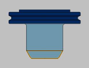

Part 4) How to Create a Tool Arbor
The tool holder created in the previous part is a CAT 50 end-mill holder. Since there is already a CAT 50 tool holder category, there is no need for My Holder 1. The next step is to eliminate this category in order to add the new tool arbor in the default CAT 50 category. This keeps all CAT 50 tool holders/arbors together in one category. In addition, when you use Delete Holder, the entire category, including the holder and all arbors is deleted. When you use Delete Arbor, you are only deleting a single arbor.
To delete the unnecessary holder category, first make sure that My Holder 1category is selected, and in the Holdersgroup, click Delete Holder.
A message displays to confirm that you want to delete the selected holder.
Make sure that My Holder 1is in this description, and click Yes. -
In the Tool Holder Category list, select CAT 50 Holder.
To create an arbor within this category, in the Arborsgroup, click Add Arbor.
Notice that the Tool Holder Definitiondialog box displays the defined tool holder.
The first arbor element, in this case the default cylinder, starts at the bottom of the tool holder. -
To name the arbor, in the Arbor Description box, type 1.0 Inch I.D. x 3 Arbor CAT 50.
This description is the label used when you assign a tool holder/arbor to a tool. -

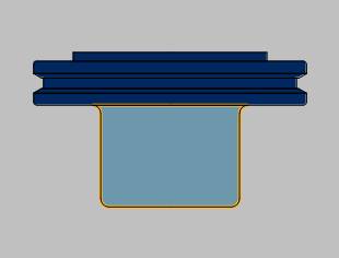

Since the first element of the arbor is a cylinder, in the Element Parametersgroup, type the following values.
In the Element List, click Add Cone, and type the following values.
Tip: The cylinder element (step 4) has a diameter of 1.97 with a bottom fillet of 0.118. The cone element (step 5) has a diameter of 1.97 with a top fillet of 0.118. When two elements share the same diameter where they meet, you can apply a fillet across the two elements. To apply the fillet across the two elements, you must use the same fillet value for each element (Top Fillet of one element and the Bottom fillet of the next).
To finalize the new tool holder/arbor, click OK.
You have added a stubby CAT 50 tool arbor to the CAT 50 category.

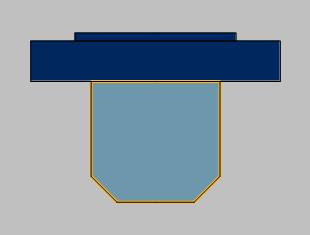

How to Measure Angle Mode
Bottom Angle Mode = 45 degrees |

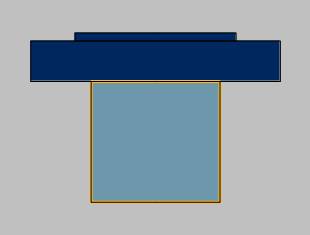

This tutorial is designed to show you how detailed you can be when creating tool holders. Although you have the ability to create an accurate tool holder model, this may not be necessary. The more detailed the tool holder is, the longer the calculation times are for simulation. Keep this in mind when creating tool holders. If you want to keep the calculation time a short as possible, you can use very simplified tool holders as shown next.
