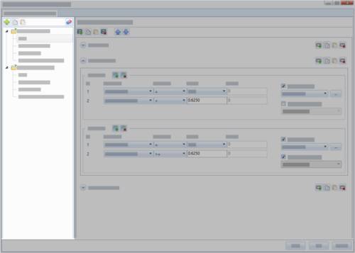

The Knowledge Base Manager
Rule Templates
Each  template is essentially a folder containing all the rules for determining which operations, and which parameters, are applied to each hole found under each particular hole type.
Tip: You can modify the existing default templates, or create your own. Perhaps you handle your holes differently depending on the machine you are working on, or the material you are working in. You can create a different template for each of these situations. Each template, will then allow you to handle each of the four hole feature types differently.
Quick access menu
By right-clicking in the template column, you can access a context menu that gives you the ability to create new templates, as well as copy, paste, and delete templates. The quick access menu gives you these same options:
Note: Clicking on a hole type in a template gives you access to its Rule Groups.
Rule Template Features
Each template is broken down into four parts, one for each of the possible hole types:
With one of these features highlighted in a particular template, the rule groups to the right will be assigned to that particular feature, and template.

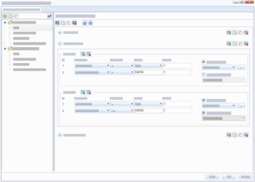

The Rule Group Section
This section is where all rules are made. The top level item in this section is the Rule Group which contains Rule Sets. It is the Rule Sets that contain the Rules themselves.
Context menu
Right-clicking along the top of a Rule Group section gives you access to the following items in a context menu:
Quick access menu
The quick access menu gives you access to the following items:
Rule Groups
Rule Groups contain Rule Sets, which are comprised of individual rules. The Rule Group contains as many Rule Sets as necessary to define what operations will be utilized when the rules are met.

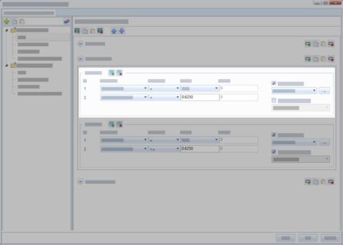

Rule Sets
Rule Sets contain at least one rule, and sometimes many rules. These rules decide what operations are added to the feature when one of those rules are met.
Tip: If you think of the Rule Group as one of the considerations of how to cut a hole, (perhaps you cut a large hole differently than a small hole) the best way to think about a Rule Set is equate them to the desired results for each one of those possibilities. (Create one Rule Set for the large hole, and one for the small hole.)
Context menu
Right-clicking along the top of a Rule Set gives you access to the following items in a context menu:
Quick access menu
The quick access menu gives you access to the following options:
Rules
Rules are the base level items for making decisions based on the data found from the model geometry for the various holes that have been identified.
Tip: If you think of the Rule Group as one of the considerations of how to cut a hole, (perhaps you cut a large hole differently than a small hole) and the Rule Sets as the desired results for each one of those possibilities, then the Rules themselves will determine what sizes are considered small, and what sizes are considered large. The Knowledge Base will then see if the identified geometry is considered large, or small and create the feature accordingly.
Important: Currently, the values entered for the rules must be numeric with the exception of the variable "Dia". This is the variable for the Diameter found for the hole which can then work in tandem with math characters like + - * /. As an example, these allow you to specify a value like "3*Dia", or three times the found diameter.

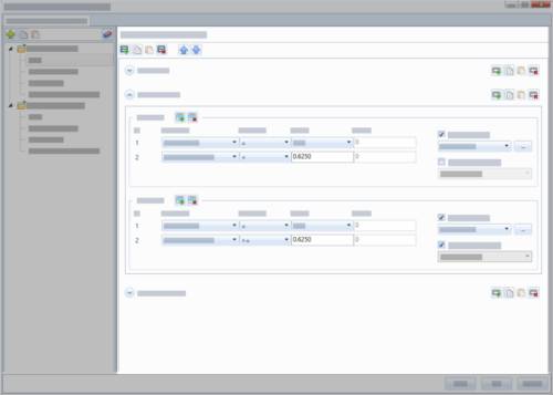

Part 1) Creating a new template
  1. In the Quick Access Menu of the Rule Templates section, click (Create new template) to create a new template.
  2. Right-click the new template and select Rename to rename the template.
  3. Enter a name for the new template.

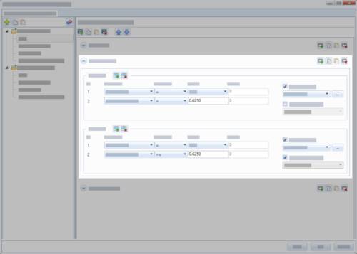

Part 2) Creating Rule Groups for Feature Types
  1. In the new template, select a Feature Type to create a Rule Group for and click (Create new rule group) to create a new rule group.
  2. Right-click the new rule group and select Rename to rename the rule group.
Part 3) Creating Rule Sets
  1. In the new rule group, click (Create new rule set) to create a new rule set.
    A new rule set, Rule Set 1, is added to the list.

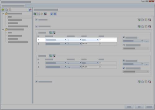

Step 1) Creating a rule
  1. In the rule set, click (Create a new rule) to create a new rule.
Determine the "if"
  1. Set the Parameter.
  2. Set the Condition.
  3. Set Value1, and Value2 when necessary.
