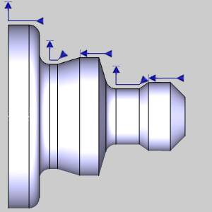

Pattern

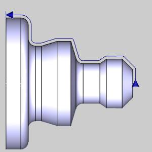

Continuous - sets the finishing
pass to a single pass along the geometry.

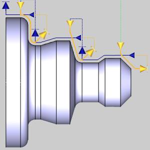

Alternate - breaks the finishing
pass into separate groups defined by either vertical faces, turned diameters,
or a combination of the two.

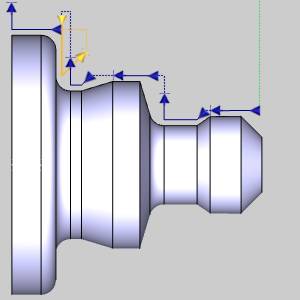

Both - will Face Vertical, and
Turn Diameter with opposing direction of cuts. ![]()

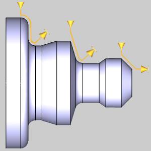

Face Vertical Only - will only
cut vertical walls.![]()

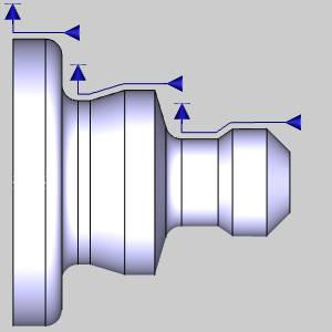

Turn Diameter Only - will only
cut geometry running parallel to the center of rotation. ![]()
Include angled walls - will allow
for geometries that are not perfectly vertical or horizontal to be cut
as well. This check box is selected by default. See the table below to see how clearing this check box can affect the various selected options.

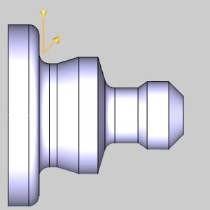

Each tool has a theoretical point placed on it as seen in red in the animation below. In the case of tools with a radius of any size, this point is not actually on the tool, but on the horizontal and vertical intersections of the radius. It is this point that the toolpath plots out. When compensation is used, it is designed to place the actual tool and not just its theoretical point on the geometry. This can be accomplished with System Compensation, Machine Compensation, or a combination of the two.
