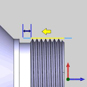

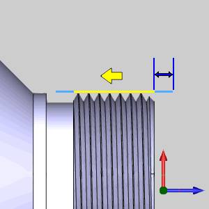

The Leads page
The Leads page allows you to set how the thread is approached at the beginning of the feature and how it exits from the feature after completion. Thread Operations contain only a single lead-in and lead-out which serve as an extension to the selected geometry.
