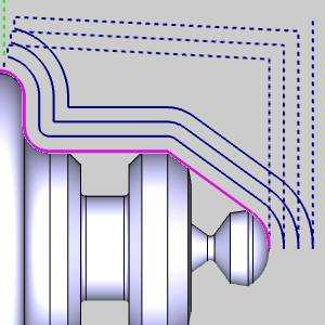

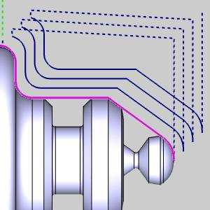

Offset - Each pass
will be an offset copy of the selected geometry trimmed to the feature
constraints.

Sorting allows you to select how the passes link to the following pass.
Standard - defines
a one-way cutting pattern with retracts between each cut.

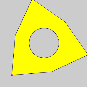

Each tool has a theoretical point placed on it as seen in red in the animation below. In the case of tools with a radius of any size, this point is not actually on the tool, but on the horizontal and vertical intersections of the radius. It is this point that the toolpath plots out. When compensation is used, it is designed to place the actual tool and not just its theoretical point on the geometry. This can be accomplished with System Compensation, Machine Compensation, or a combination of the two.
