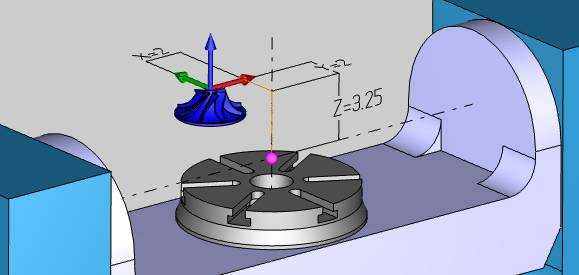

The Machine Setup dialog box is used to set the machining origin or work offset for the part on the machine. When this dialog box is opened, the stock shows the bounding box made of lines and points. These lines and points are automatically created, for your convenience, to use when setting the machining origin. By default, the machining origin is located at the WCS or world coordinate system (X0 Y0 Z0) as shown next.
The previous image has shading turned off to better show the bounding box selection entities.
  1. If you want to use the top and center of the stock as the machining origin, click Reset to Stock Coordinate.
    This uses the stock origin from the Stock Definition dialog box.
  2. To change the machining origin to a different location, in the Origin group, make sure Pick Origin is selected, and click in the Pick Origin list box to give it focus, and select the desired location from geometry in the graphics area.
    Once you pick a point, the machine setup is automatically moved.
Tip: The bounding entities that are created in the Machine Setup dialog box are for your convenience in setting the machining origin. You are not limited to using these entities when setting the machining origin. To alter the alignment of a particular axis, click in its list box to give it focus, and then select an entity in the graphics area. Selecting a line will set the axis parallel to it. Selecting a point will direct the axis along the line formed between its zero and the selected point.
  1. The machining origin is now set to the lower-left corner on the top of the stock.
  2. Set the Work Offset to describe the difference between the selected machine setup, and the machine zero.
  3. Set the Clearance Plane to be used for the job.
  4. To finish the Machine Setup, click OK.
You are now ready to create CAM features.
