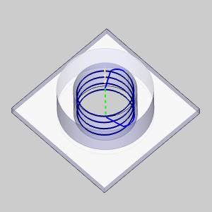

Part 7) Define the Operation Parameters
  1. In the Pattern group, leave the default of Top Down for the Method and Inside for the Thread Type.
    Click Next>> to define the Parameters.
  2. This example uses the default Right Hand.
  3. To create the 2-inch thread, set the Thread Diameter to 2.000.
    (This value is adjusted because the surface edge that was selected is smaller than the thread diameter. The Diameter in the Feature page can be set to the actual thread diameter, but (for the Threading feature) it can also be used to define the diameter for any non-thread mill operations that are added. This is why there is a separate diameter on the Thread Mill Parameters page of the wizard.)
  4. To define the thread height, use the equation: 2 - 1.8125 = 0.1875.
    This is our major diameter minus the minor diameter of the thread. Then we divide the result by 2.
    Set the Thread Height value to 0.0938.
  5. The thread pitch, or threads per inch, is 1/6 or 0.167.
    Because we are creating a 2-start thread, we multiply this value by 2.
    In the Thread Pitch box, type 0.333.
  6. For this example, leave the Thread Start Angle set to 0.00.
  7. Click Next>>, and in the Lead-in group, select Helical.
In the Radius box, type 0.300.
To create the toolpath, click Compute.
The result is shown next (the part is made transparent to make it easier to view the toolpath).

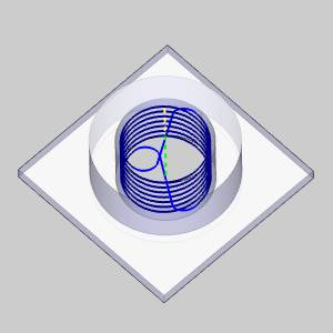

Part 8) Add the Toolpath Pattern
  1. In the CAM Tree, right-click Feature Mill Thread - 2.000, and click Add Toolpath Pattern.
  2. In the Toolpath Pattern dialog box, click Rotate, and click Next>>.
  3. In the Rotate group, set the Angle to 180, and set the Copies to 1.
  4. Because the machining origin is placed at the center of the thread, which is also the center of rotation for the pattern, the Rotation Axis Origin values are X0 Y0.
  5. To compute the toolpath pattern, click OK. The result is shown next.
The multi-start thread is now complete.
