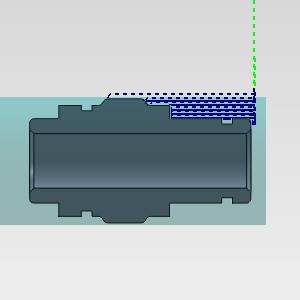

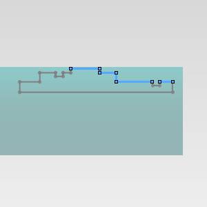

    • Select Geometry - opens the Re/Select Geometry dialog to allow you to select the geometry from which the feature will be created. You can select wireframe, spline geometry, surfaces, and even surface edges but the geometry should be in the XZ plane of the machining origin (work offset). Click (OK) to confirm the selection and return to the wizard.

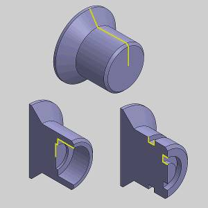

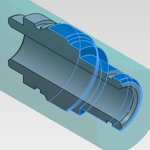

When creating any Turning feature, BobCAM analyzes the profile of the selected geometry. The XZ plane is considered the zero degree starting point. BobCAM analyzes the part in different section planes. The First section plane start angle and the Interval angle between section planes options decide exactly how many section planes are used to analyze the part. For example, if First section plane start angle is set to zero degrees (the XZ plane) and Interval angle between section planes is set to 90 degrees, the profile of the part is analyzed in four different section planes.
Tip: The location of the section planes for a part can be viewed by selecting the Display Section Planes check box in the Selection Manager.

  • Display Section Planes - Select the check box to show the section planes location on the part as a preview in the graphics area.
    Display Section Planes - Clear the check box to hide the section planes preview in the graphics area.
  • Enter Section Angles - The following parameters display when Enter Section Planes is selected.
    • Start Angle - is the reference angle to which BobCAM begins analyzing the profile of the feature geometry. The zero degree location is the XZ plane (by default).
    • Interval Angle - a new section plane is created at this interval for determining the number of section planes used to analyze the part geometry.
    • The Section Angles box displays all angles at which a section plane is created. You can click the angles listed in this box to highlight the section plane in the graphics area (Display Section Planes must selected.)
  • Pick Section Angles - When this option is selected, you can set the section planes by selecting points or vertices in the graphics area. The entities that you select display in the box under Pick Section Angles.
    • Pick Section Angles list box - Lists all points or vertices selected from the graphics area. To access a shortcut menu for removing selections, right-click inside the box.
Spun Profile
This section appears when the Spun Profile method is selected for the Feature Extraction Method.
  • Arc Fit - creates arcs as the extracted geometry where possible based on the tolerance selected.
    Arc Fit - creates only lines as the extracted geometry.
