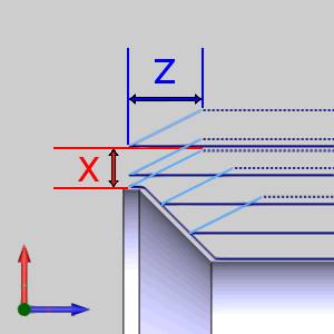

Lead-in Z - sets the distance and direction of travel, in the Z-axis, for the approach into the toolpath
Lead-in X - sets the distance and direction of travel, in the X-axis, for the approach into the toolpath

Lead-out Z - sets the distance and direction of travel, in the Z-axis, for the approach into the toolpath
Lead-out X - sets the distance and direction of travel, in the X-axis, for the approach into the toolpath
