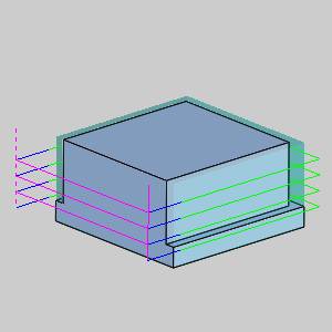

- Minimize Retracts
- With this check box cleared, before beginning the next pass, the tool will rapid up to the Rapid Plane, rapid back down nearly all the way to the last depth before engaging the material at the Plunge Feedrate. The point it rapids down to will be equal to the last depth, plus the amount being used for the features Feed Plane value.
- helps prevent the tool from lifting back up to the rapid height before the next cut.
- Link with Rapid
- will connect the passes with a feed move at depth.
- will connect the passes with a rapid move at depth.
- Link with Rapid
Retracting |
Minimize Retract |
Link with Rapid |
Tip: Normally, at the end of a pass, the tool retracts to the rapid plane, moves to the X, Y position of the next cut, rapids down to the feed plane, feeds to the proper depth, then starts the next pass. Minimize Retracts will help to eliminate moves back to the rapid plane between passes with a few exceptions: If the direct link intersects with any part of the toolpath chain, the toolpath will go to the rapid plane between passes. If the direct link is on the opposite side of the offset direction, the toolpath will go to the rapid plane between passes. When no offset direction is set by system or machine compensation, left side compensation is assumed by the system.

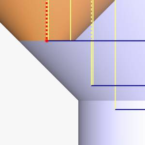

Depth of Cut - When using Multiple Steps, this is the depth at which all passes, prior to the final depth, will be taken.
Depth of Cut
Final Depth

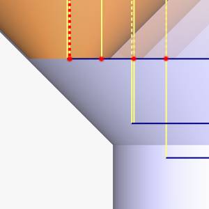

- Stepover
- will add side roughing steps to each Depth of Cut prior to the final depth. The value entered will set the step over amount which all steps, prior to the final step, will use.
Stepover
Final Step
- With this check box cleared, no stepover will be used.

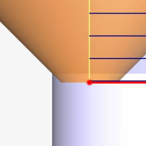

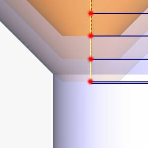

Sort by - allows you to choose, in which order, the depths and steps are to be handled.
Passes - sets the order to complete all depths on the first step, before moving onto the next step.
Slices - sets the order to complete all the steps on the first depth, before moving onto the next depth.
