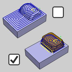

    •  Trim adaptive passes - when this option is selected, the Adaptive result is trimmed to the remove excessive cuts from areas they are not needed. Click on the images below to see each in action
      - Clear the check box to turn off the Trim adaptive passes.
      - Select the check box to turn on Trim adaptive passes. This localizes the adaptive cut to the areas in which it is required.
      Trim adaptive passes Trim adaptive passes

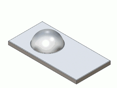

  • Perpendicular - This option creates opposing (perpendicular) passes when the height change between toolpath slices exceeds the specified threshold value. This helps provide a better finish for steep areas of the feature using the Stepover, Pass Extension, and Threshold Distance parameters.Stepover - defines the distance between each pass in X and Y, or the XY plane.
    •  Stepover - defines the distance between each pass in X and Y, or the XY plane.
    • Pass Extension - adds the specified distance to the perpendicular passes of the toolpath to help blend the transition between the perpendicular cutting directions.
    • Threshold Distance - determines the maximum allowable height change from one toolpath pass to the next before perpendicular passes are created.

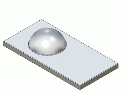

  • Machining Tolerance - the amount of variation allowed for creating the toolpath for the feature. The accuracy of the toolpath does not exceed this range.
  • Cut Holes - extends the toolpath into any holes that may be present in the surface.
  • Ignore Holes - does not place the toolpath into any holes and treats the surface as if it is continuous and unbroken.
