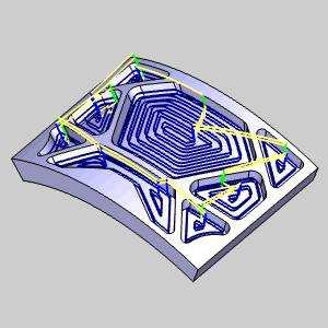

Multiaxis Machining
The Multiaxis Roughing operation is used to rough large amounts of material with multiaxis movements. The tool tilting is defined using the surface normal direction of the part geometry. This feature type requires multiple surface selections depending on the selected pattern. This topic explains the Multiaxis Wizard parameters that are available when using the Multiaxis Roughing feature type.
Surface Paths

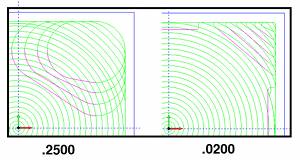

Cut Tolerance - type a value to define how accurate the toolpath is in relation to the selected geometry. Smaller values create a more accurate toolpath but also increase calculation times.
Tip: You can reduce the cut tolerance value, for example from 0.0005 to 0.005, to speed up the toolpath calculation while creating and modifying your toolpath. Once your are happy with the result, you can then set it back to the original tolerance to calculate the toolpath before posting the output.

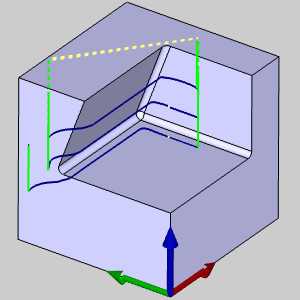

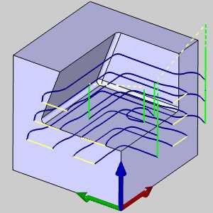

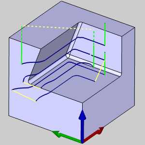

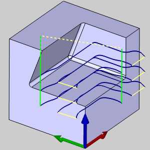

Roughing
Stock Definition
The Multiaxis Roughing feature requires that the following check box is selected in order to create a toolpath.
Stock Definition
Select the check box to enable the Multiaxis Stock Definition parameters.
Click Stock Definition to open the Stock Definition dialog box.
If you clear the check box no toolpath is created.
