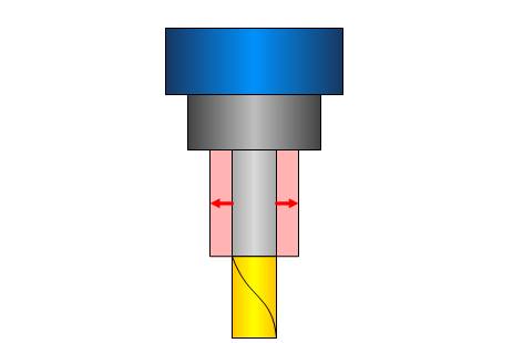

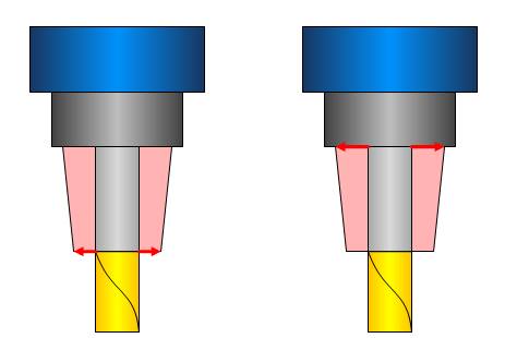

Clearance type
Cylindrical - applies a cylindrical offset to the holder, arbor and shaft.
Conical - applies a conical offset to the holder, arbor and shaft.

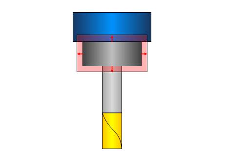

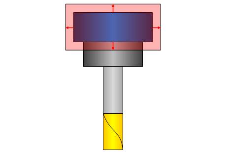

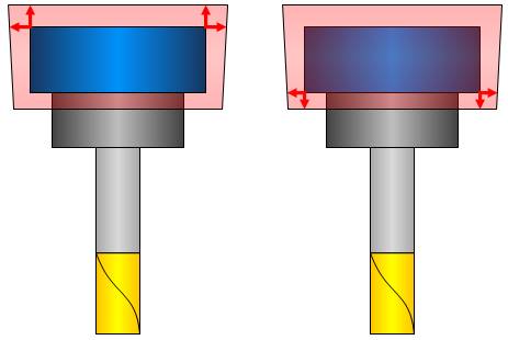

Clearance values
The available Clearance values define the clearance for the Shaft, Arbor, and Holder. While there is a single value available when the Cylindrical Clearance type is used, there are two values, defining the top and bottom, when a Conical Clearance value is used.
Important: These values should be greater than the allowance being left on the surfaces.

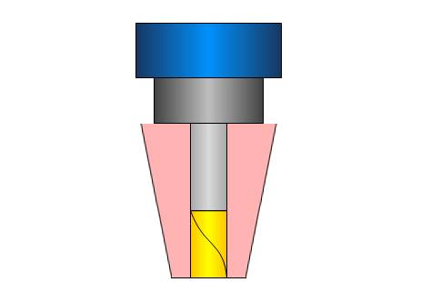

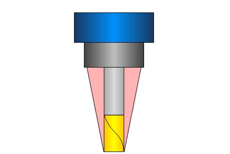

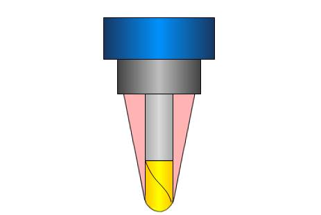

Angular clearance
The Angular clearance creates a conical clearance area around the tool. The angles origin varies based on the type of tool selected. In the case of a flat end mill, the angle will originate from the bottom diameter of the tool. In the case of an end mill with a radius, the angle will originate from the tangency of the radius.
End Mill | Ball End Mill |

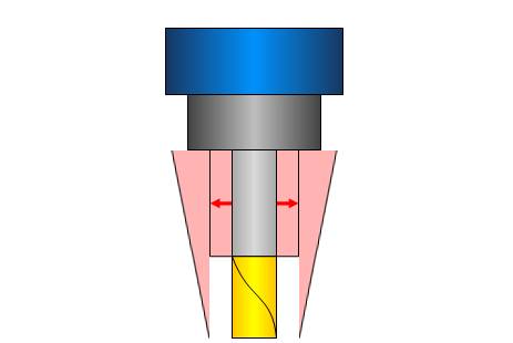

Note:
When Angular clearance is used in conjunction with the regular clearance values, clearance values will extend the area of angular clearance.
