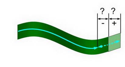

  • This image shows a single cut on a curved surface. Imagine that the toolpath is a string. When the toolpath is trimmed, then the string is shortened. When the toolpath is extended, the string is longer.

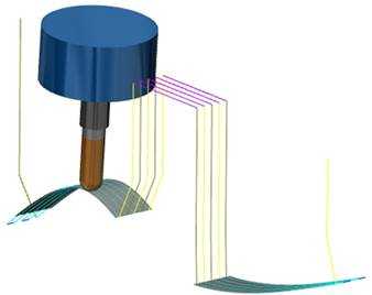

  • In the next image the start of the toolpath is extended and the end is trimmed.

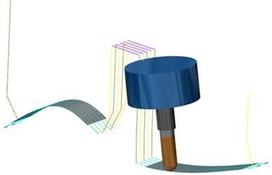

  • This example shows that the extension is applied on a gap.

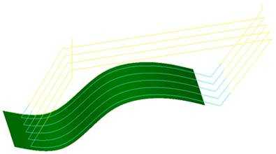

  • This example shows that the extension won't be applied on a gap.
