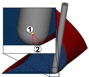

  • Morph Between Two Surfaces
The area type has to be set to Full, Start and End at Exact Surface Edge because the distance between the margin and the first cut depends on the exact position of the surface edge. You see in the next image why it is so important. In this impeller example you have an inlaying edge. The toolpath has to fit in that edge to avoid a gouge. When you set a margin equal to the tool radius (1), the tool is kept that distance from floor face and blade face (2). Always use a Margin that is at least the same as the tool radius.
