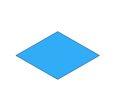

Parallel Cuts with a small step over.

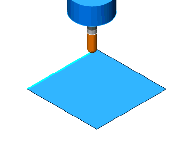

The same example with a larger step over.
