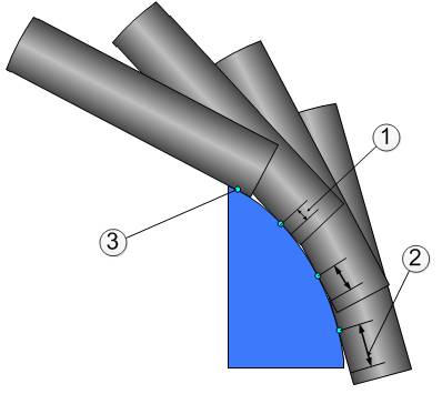

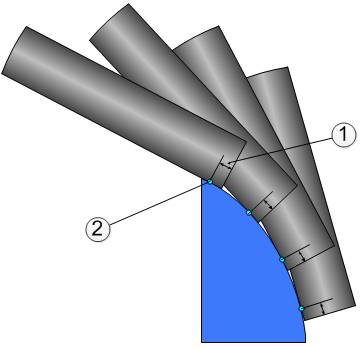

Axial Shift
The Axial Shift parameter is an offset applied to the tool along its axis. The result is that different parts of the flute are used for cutting at different parts of the toolpath. The Axial Shift section of the Utility tab is described next.
You can select one of the following options for an axial shift.
- Constant for Each Contour - applies a constant axial shift to the tool for each toolpath contour. In the following image, (1) shows the axial shift distance (To value) is constant at each toolpath contour (2).
- Gradual for All Cuts - applies an axial shift gradually (using the From and To distance values) for each new cut. The result is that a different part of the tool is used for each new cut. The following image shows (1) the Fromdistance value, (2) the To distance value, and (3) each cut.
- Gradual for Each Contour - applies an axial shift gradually (using the From and To distance values) for each new toolpath contour. The result is that a different part of the tool is used for each new contour. The following image shows (1) the From distance value, (2) the To distance value, and (3) the starting contour.
After selecting an option, you must set the distance values for the axial shift. When using Constant for Each Contour, only the To distance value is available since the shift is constant.
To - type the axial shift distance for the beginning of the toolpath.
From - type the axial shift distance for the end of the toolpath.
Note: Positive values cause the tool to retract and negative values cause the tool to plunge (in-feed).

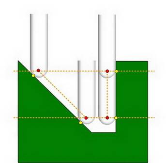

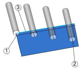

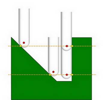

- Calculation Based on Tool Center
Select the check box to use calculations based on the tool center.
Clear the check box to use calculations based on the tool tip.
The following image shows calculations based on tool tip (surface contact point).
The following image shows calculations based on tool center.
