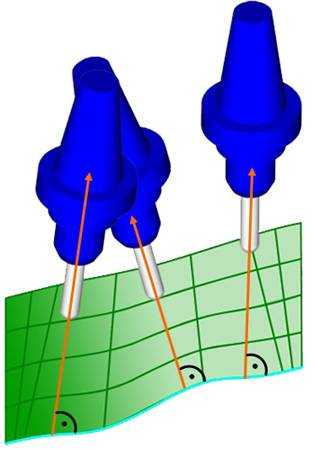

With this side-tilt definition, the tool axis is always orthogonal to a selected lower curve. Use this option when the lead angle direction should be defined by the toolpath direction. If you set a Lead Angle to Cutting Direction in the Tool Axis Control tab, then this angle is added to the orthogonal orientation. This option is only available for Multiaxis features that require multiple Edge Curve geometry selection (Morph Between Two Curves and Parallel to Multiple Curves).

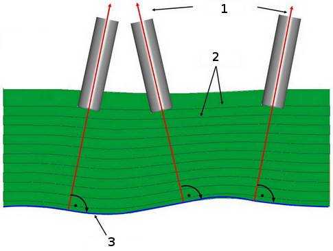

  • The surface is curved at the upper and lower edge. The toolpath (2) is parallel to the lower edge (3). The tool (1) is always orthogonal to the toolpath.
