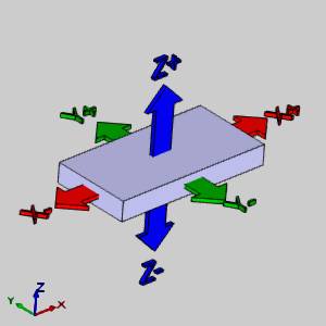

Offset
This group is used to extend or trim the stock geometry along any of the Cartesian axes. You can type positive or negative values to extend or trim the stock respectively in each direction.
Offset Diagram | |

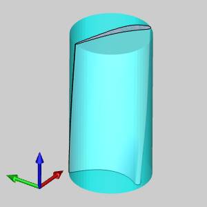

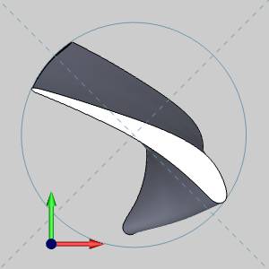

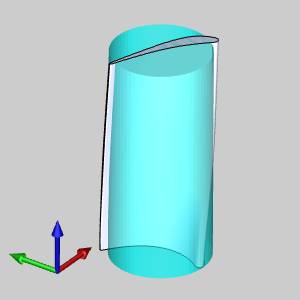

Bounding Box - sets the stock by using the extents of the selected Geometry Option to create a bounding box that will center the stock. The diameter of the stock is then equal to the longest side of the rectangular bounding box.
Note: While the default Bounding Box option works fine in most cases, the image above shows a scenario in which it fails to enclose all of the geometry in the cylindrical stock. The Bounding Box is shown with dotted lines. Notice that the Bounding Box itself encloses the geometry, while the arc that is created fails to.
Bounding Cylinder - uses an algorithm to calculate the smallest possible cylinder to enclose the geometry selected with the Geometry Option to create stock.

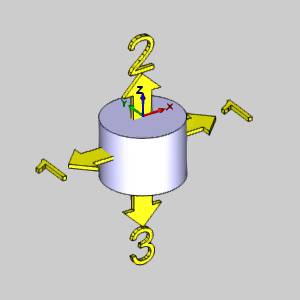

Offset
This group is used to extend or trim the cylindrical stock geometry. You can type positive or negative values to extend or trim the stock respectively in three directions.
Offset Diagram |
