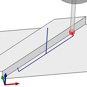

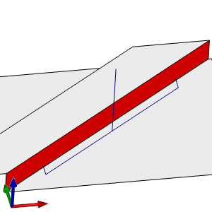

This cycle measures a surface which is neither parallel to the X Axis, nor the Y Axis.In this cycle, the moves toward the surface are always in the Y Axis.This cycle can utilize the following geometry inputs:
- A line which is not parallel to the X or Y Axes.
- A planar surface edge which is not parallel to the X or Y Axes.
- A planar surface whose normal is not parallel to the X or Y Axes.

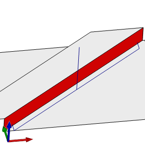

By default the Selected Geometry list is given focus to allow you to select geometry from the graphics area. - Select a planar surface whose normal is not parallel with the X or Y Axes, or the edge of that surface.
Since this geometry could be interpreted as being for an Angled Surface in the XY Plane cycle, that is the cycle currently selected for us.

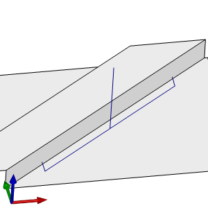

The Parameters section for this cycle consists of the Z Measurement Height, the X value, the Angle value, and the Distance value.In this case we do not really need to adjust the height at which the probe will make contact.The X value and the Angle value should not need to be adjusted since they are calculated automatically and list the position of the intended surface to be measured and the angle of that surface to move along.The Distance value determines the spacing between the contact points.For this example, we will only update the Distance.
- In the Parameters section, update the Distance value by adding -1.00 to the end, and pressing Tab.
The toolpath updates.

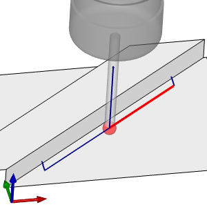

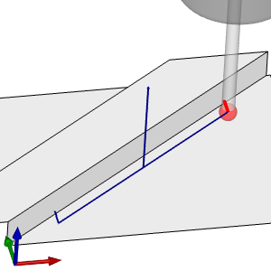

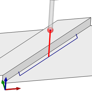

The Backplot dialog launches. - Click Next to view the probe movements.
