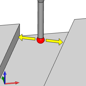

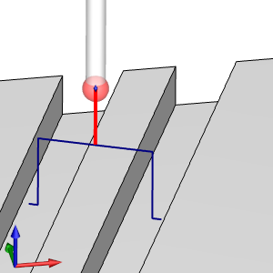

This cycle measures the distance between two planar surface faces which are parallel with each other, but not to the X Axis, nor the Y Axis.This cycle can utilize the following geometry inputs:
- Two parallel lines which are not parallel to the X or Y Axes.
- Two parallel planar surface edges which are not parallel to the X or Y Axes.
- Two parallel planar surfaces whose normals are not parallel to the X or Y Axes.
Note: The probe can be made to lift between measurements to avoid obstacles The touch points move away from each other as it is meant to measure pockets.

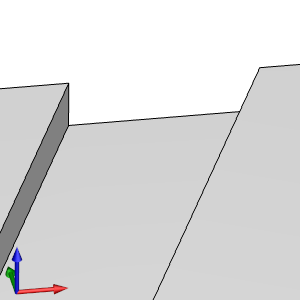

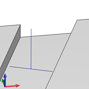

Example 1 - Angled Pocket
In this example we:
- Select the Probe feature.
- Select the cycle.
- Updating the cycle.
- Utilize the Options page.
- Backplot the result.
Part 2) Selecting the Probe
Part 4) Selecting the Cycle

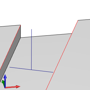

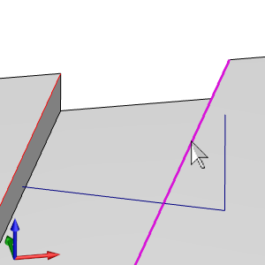

- Click the Parameters tab.

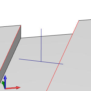

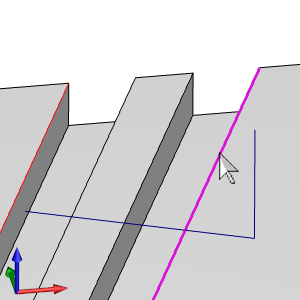

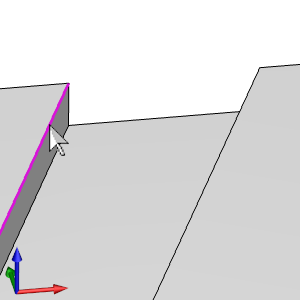

By default the Selected Geometry list is given focus to allow you to select geometry from the graphics area. - Select the edge of one of the planar surfaces whose normal is not parallel with the X or Y Axes.
Since our current geometry works for a Angled Surface in XY Plane cycle, that is the cycle that is currently selected for us. - Select the edge of the parallel surface.

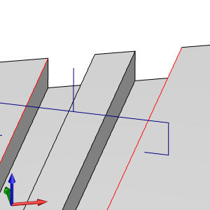

Part 5) Updating the cycle
In this case, the geometry we have chosen could be interpreted as a Angled Web cycle.Had we chosen the planar surfaces themselves instead of the edges, the proper cycle would be selected already.However, since we did not, we will need to update the currently selected cycle.
- At the top of the Cycles section click the drop down list and select Pocket from the list.
Part 6) Adjusting the Initial Position
Part 7) Updating the Parameters section

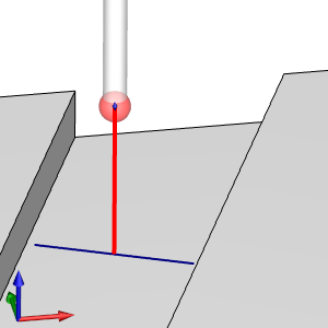

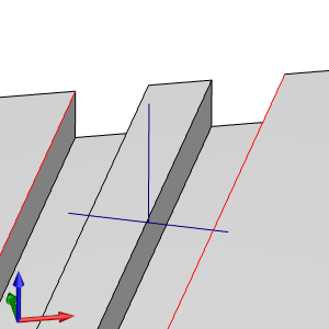

The Parameters section for this cycle consists of the Z Measurement Height, the Pocket Width and the Update Work Offset value.In this case we only want to adjust the height at which the probe will make contact.The Pocket Width is automatic and should not need to be adjusted, and the Update Work Offset value can be used as needed.

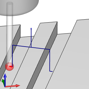

- In the Parameters section, update the Z Measurement Height value by adding -0.25 to the value and pressing tab.
The toolpath is Z value is updated, and in a side view we can see the toolpath has updated to reflect the height at which the probe will make contact.

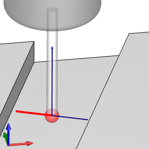

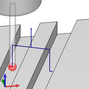

The Backplot dialog launches, and the probe and first move become visible. - Click Next twice to view the probe movements.

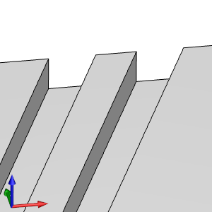

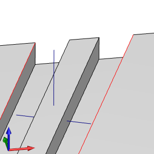

Example 2 - Angled Pocket with Web
In this example we:
- Select the cycle.
- Update the cycle.
- Update the Options section.
Note: The Pocket measure cycle measures the distance between two parallel surfaces that are both either parallel with the Y Axis, or the X Axis.In this case we measure two surfaces parallel with the Y Axis.

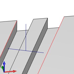

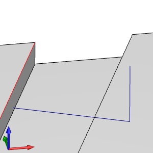

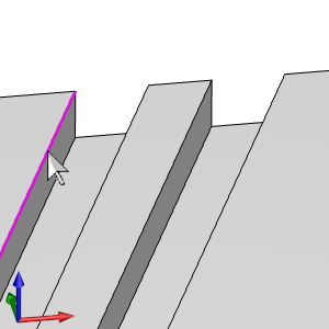

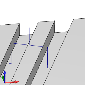

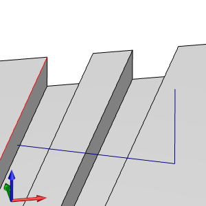

In this case, the geometry we have chosen could be interpreted as a Web cycle.Had we chosen the planar surfaces themselves instead of the edges, the proper cycle would be selected already.However, since we did not, we will need to update the currently selected cycle.

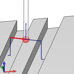

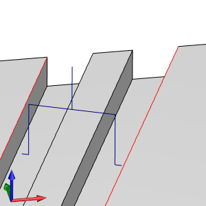

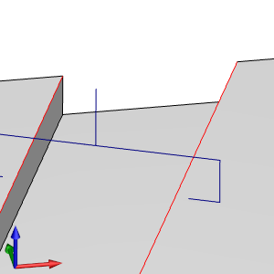

In this case the only parameter we will be updating is the height at which the probe makes contact.We will adjust it so that we make contact one eighth of an inch below the top edge of the pocket.
- In the Parameters section, update the Z value by adding -0.25 to the value and pressing tab.
The toolpath is Z value is updated, and we can see the toolpath has updated to reflect the height at which the probe will make contact.
Part 8) Updating the Options section
The Options section for this cycle consists of the Radial Clearance value only.Selecting this check box will update the moves to first avoid an obstacle before dropping down.The value will allow you to set how close to the surfaces to move before dropping down to the contact depth.

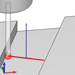

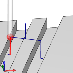

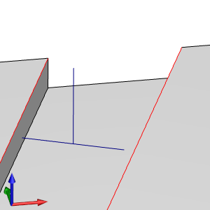

- In this case it looks like the radial clearance we used it fine to clear the obstacle.Click Next two more times to ensure the probe is clear.
- Click Close.
