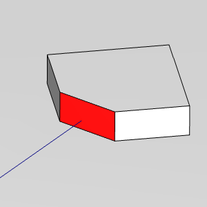

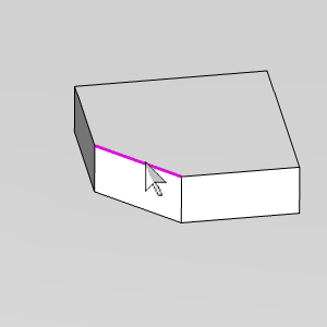

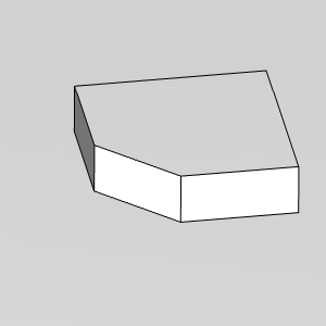

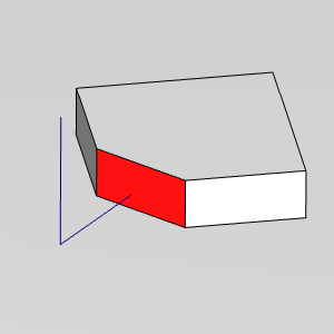

By default the Selected Geometry list is given focus to allow you to select geometry from the graphics area. - Select the edge of the surface whose normal is not parallel to the X, or Y Axis.
Since our current geometry only works for a few cycles, the intended cycle is currently selected for us.

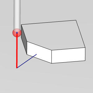

Note: Notice we are on the wrong side of the surface though.This could easily be corrected with the Other Side button in the Initial Position group, but we will update the geometry instead.
Part 5) Updating the geometry

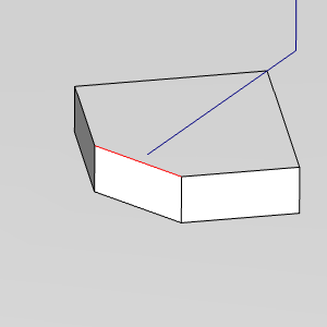

In this case, the geometry we have chosen is interpreted as an External Corner cycle.The probing feature can do quite a bit of intelligent placement of the toolpath based on the surfaces selected.When edges are the only thing used for geometry selection, not as many assumptions can be made for the intelligent placement of the toolpath.We will take a look at how the geometry selection affects the automatic placement of the created toolpath.
- Next to the Selected Geometry list box, click the
Delete All button.

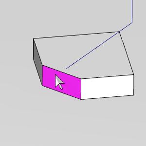

The geometry is removed from the list, and the edge is no longer highlighted. - Select the surface whose normal is not parallel to the X, or Y Axis.
The surface is added to the Selected Geometry list, and the toolpath updates.
Notice this put the toolpath on the correct side of the part, as well as sets a more reasonable Z Measurement Height.

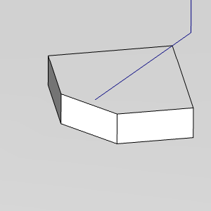

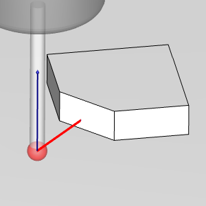

The Parameters section for this cycle consists of the Z Measurement Height, X and Y values, Angle, Distance value, and the Update Work Offset value.In this case we do not really need to adjust the height at which the probe will make contact.The X and Y values could be adjusted to update the point at which the probe will make contact, but will be left as they are for this example.The Angle value can not be adjusted, so for this example, we will update the Distance.
Note: The value of the Z Measurement Height is an incremental height from the Machine Setup.In this case, our Machine Setup is at the top of the part.
- Update the value of the Distance to 1.00.
The toolpath is updated.

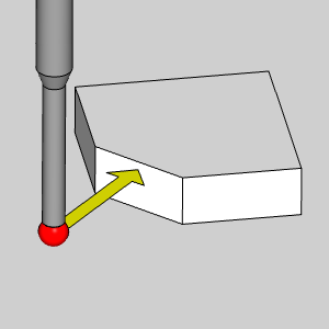

- Click the Options tab.
The Backplot dialog launches, and the probe and first move become visible. - Click Next two times to view the probe movements.
- Click Close.
