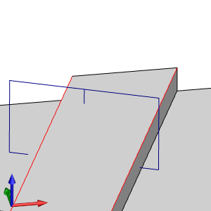

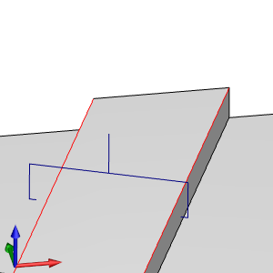

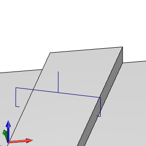

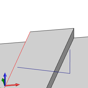

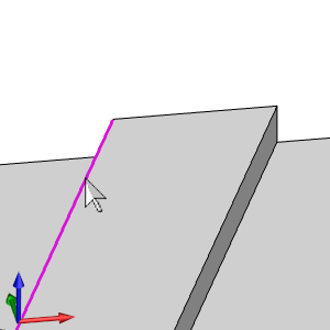

By default the Selected Geometry list is given focus to allow you to select geometry from the graphics area. - Select the edge of one of the planar surfaces whose normal is not parallel with the X or Y Axes.

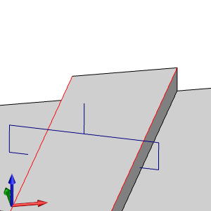

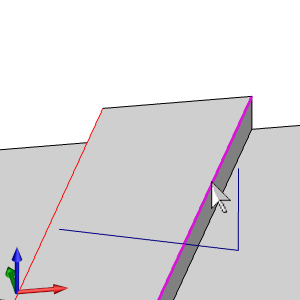

Since our current geometry works for a Angled Surface in XY Plane cycle, that is the cycle that is currently selected for us. - Select the edge of the parallel surface.

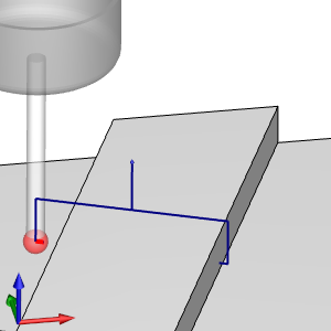

The value and the toolpath update to put the initial position back in its original position. - In the Initial Position group, update the Z value by adding -0.75 to the end, and pressing Tab.
The value and the toolpath update to put the moves out from the initial position three-quarters of an inch further down toward the part.

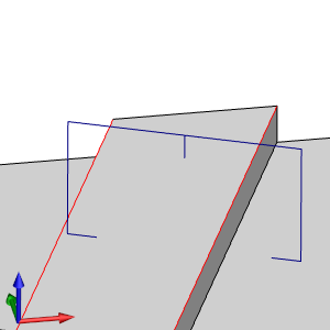

The Options section for this cycle consists of the Radial Clearance value only.This value will allow you to set how far past the surfaces to move before dropping down to the contact depth.
- Click the Options tab.

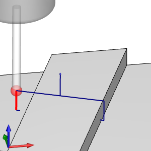

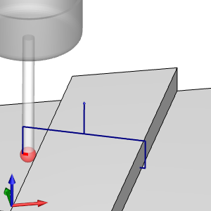

The Backplot dialog launches. - Click Next three times to view the probe movements.
- Click Close.
