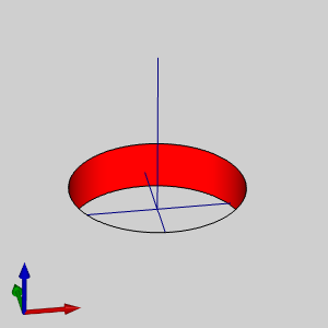

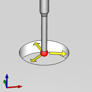

This cycle measures a cylindrical cut extruded in the Z Axis with 3 points.This cycle can utilize the following geometry inputs:
- An arc whose normal is parallel to the Z Axis.
- A cylindrical surface edge whose normal is parallel to the Z Axis.
- A cylindrical surface whose normal is parallel to the Z Axis.
Note: The probe can be made to lift between measurements to avoid obstacles The touch points move away from each other in the X and Y Axes as it is meant to measure cylindrical cut extrusions.

First Angle - defines the direction of the first touch point with the X positive direction at 0°.
Second Angle - defines the direction of the second touch point with the X positive direction at 0°.
Third Angle - defines the direction of the third touch point with the X positive direction at 0°.
Diameter - determines the width between surface contact points.

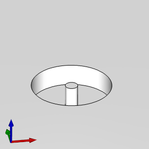

Example 1 - Bore (3 Point)
In this example we:
- Select the Probe feature.
- Select the cycle.
- Update the cycle.
- Utilize the Options page.
- Backplot the result.

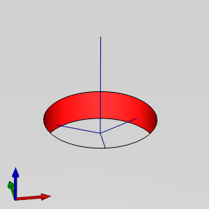

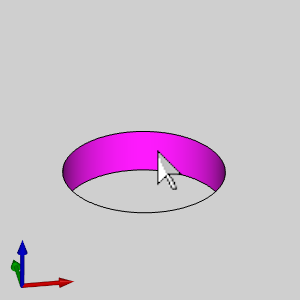

- Click the Parameters tab.

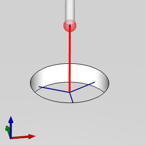

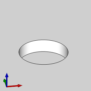

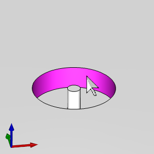

By default the Selected Geometry list is given focus to allow you to select geometry from the graphics area. - Select a the cylindrical surface of the bore, which has been cut along the Z Axis.
Since our current geometry works for a Bore (4 point) cycle, that is the cycle that is currently selected for us.

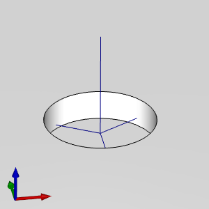

Part 5) Updating the cycle
In this case, the geometry we have chosen could be interpreted as a Bore (4 point) cycle.Since this is not the cycle we intended to use, we will need to update the currently selected cycle.
- At the top of the Cycles section click the drop down list and select Bore (3 point) from the list.

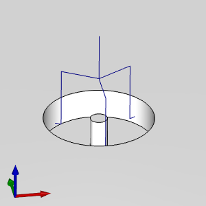

Part 6) Adjusting the Initial Position
Note: Since our contact points are arranged in a radial pattern, adjusting the X,Y Initial Position will not work.However, we can adjust the Z Axis.
Part 7) Updating the Parameters section
The Parameters section for this cycle consists of the Z Measurement Height, the angles on which the contact points will extend, the Diameter and the Update Work Offset value.In this case we do not really need to adjust the height at which the probe will make contact.The diameter is automatic and should not need to be adjusted, and the Update Work Offset value can be used as needed.In this part, let's just take a look at adjusting some of the angles.

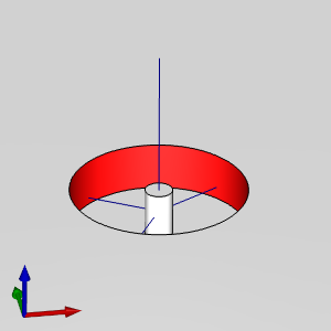

- In the Parameters section, update the Third Angle value to 170 and pressing tab.
The angle is updated, and we now have each contact point separated equally around the boss.

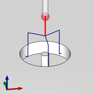

Part 9) Backploting the result

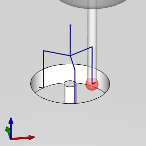

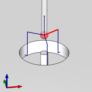

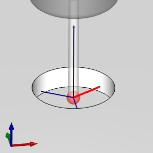

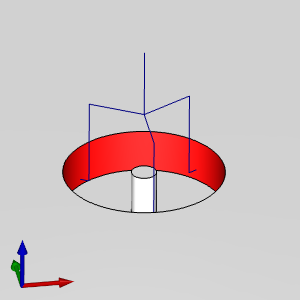

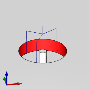

The Backplot dialog launches, and the probe and first move become visible. - Click Next three times to view the probe movements.
- Click Close.

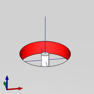

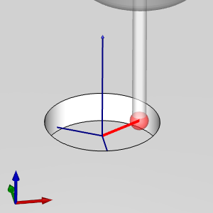

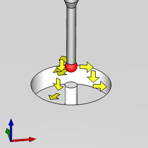

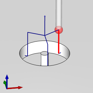

Part 6) Updating the Options section
The Options section for this cycle consists of the Radial Clearance value only.Selecting this check box will update the moves to first avoid an obstacle before dropping down.The value will allow you to set how close to the surfaces to move before dropping down to the contact depth.
Part 7) Adjusting the Initial Position

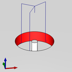

- In the Initial Position group, update the Z value to 0.3.75, and press Tab.
The value and the toolpath update to put the moves out from the initial position closer to the part in Z.
Part 8) Updating the Parameters section

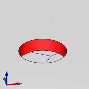

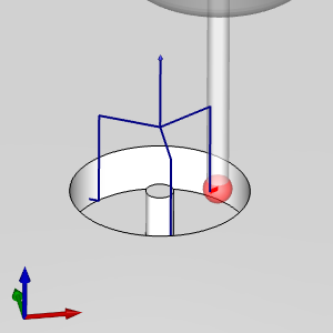

Part 10) Backploting the result

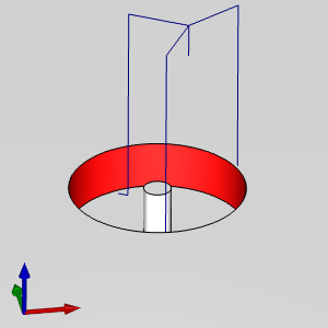

The Backplot dialog launches, and the probe and first move become visible. - Click Next four times to view the probe movements.
- Click Close.
