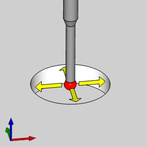

This cycle measures a cylindrical cut extruded in the Z Axis with 4 points.This cycle can utilize the following geometry inputs:
- An arc whose normal is parallel to the Z Axis.
- A cylindrical surface edge whose normal is parallel to the Z Axis.
- A cylindrical surface whose normal is parallel to the Z Axis.
Note: The probe can be made to lift between measurements to avoid obstacles The touch points move away from each other in the X and Y Axes as it is meant to measure cylindrical cut extrusions.

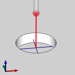

Example 1 - Bore (4 Point)
In this example we:
- Select the Probe feature.
- Select the cycle.
- Utilize the Options page.
- Backplot the result.

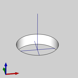

Note: The Pocket measure cycle measures the distance between two parallel surfaces that are both either parallel with the Y Axis, or the X Axis.In this case we measure two surfaces parallel with the Y Axis.

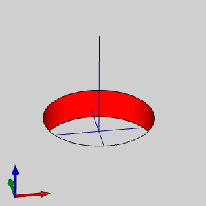

- Click the Parameters tab.

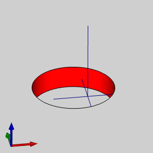

By default the Selected Geometry list is given focus to allow you to select geometry from the graphics area. - Select a the cylindrical surface of the bore, which has been cut along the Z Axis.
Since our current geometry works for a Bore (4 point) cycle, that is the cycle that is currently selected for us. - Select the edge of the parallel surface.
Note: Since our contact points are arranged in a radial pattern, adjusting the X,Y Initial Position will not work.However, we can adjust the Z Axis.

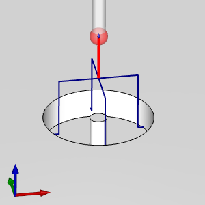

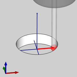

Part 6) Utilizing the Options page
- Click the Options tab.
Part 7) Backploting the result

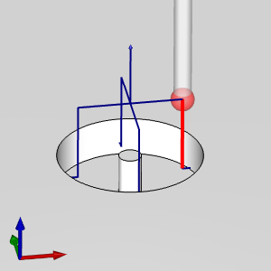

The Backplot dialog launches, and the probe and first move become visible. - Click Next three times to view the probe movements.
- Click Close.

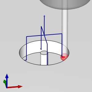

Example 2 - Bore (4 Point) with obstacle
In this example we:

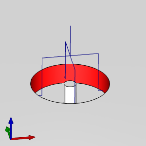

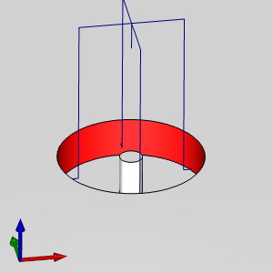

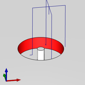

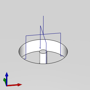

Part 5) Updating the Options section
The Options section for this cycle consists of the Radial Clearance value only.Selecting this check box will update the moves to first avoid an obstacle before dropping down.The value will allow you to set how close to the surfaces to move before dropping down to the contact depth.
Part 6) Adjusting the Initial Position

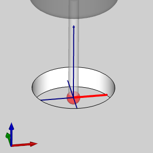

- In the Initial Position group, update the Z value to 0.3.75, and press Tab.
The value and the toolpath update to put the moves out from the initial position closer to the part in Z.

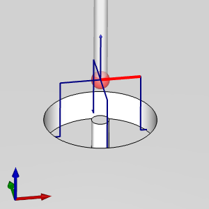

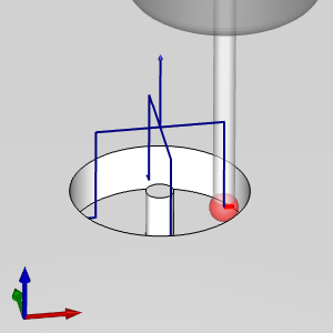

The Backplot dialog launches, and the probe and first move become visible. - Click Next four times to view the probe movements.
- Click Close.
