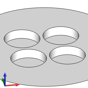

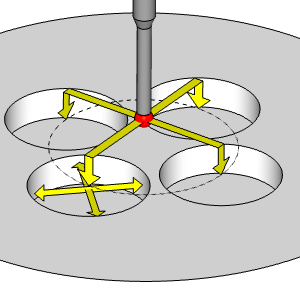

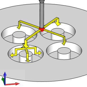

This cycle measures, with 3 points each, a radial pattern of cylindrical cut extrusions which have been cut along the Z Axis.This cycle can utilize the following geometry inputs:
- All arcs of a circular pattern whose normals are all parallel to the Z Axis.
- All cylindrical surface edges of a circular pattern whose normals are all parallel to the Z Axis.
- All cylindrical surfaces of a circular pattern whose normals are all parallel to the Z Axis.

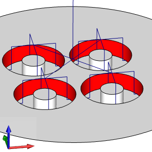

The cycle can be selected with the drop down list under the Cycles section, but simply selecting the appropriate geometry will usually select the required cycle automatically.Since certain geometry could be applicable to several cycles, in some cases, the list will become much smaller.
- Click the Parameters tab.

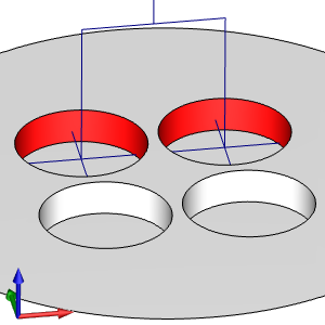

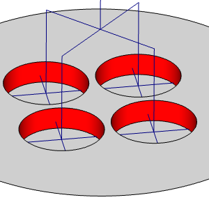

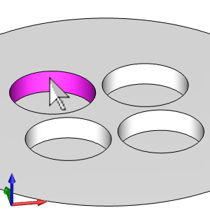

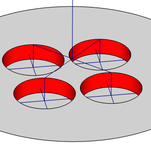

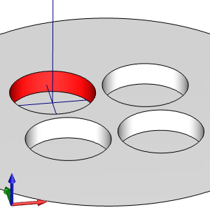

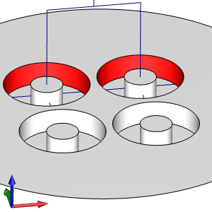

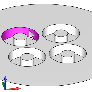

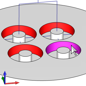

By default the Selected Geometry list is given focus to allow you to select geometry from the graphics area. - Select one of the cylindrical surfaces which has been extruded along the Z Axis, or the edge of that surface.
The geometry is added to the Selected Geometry list, the Initial Position and Parameters section are populated, and the toolpath becomes visible. - Select another of the cylindrical surfaces.

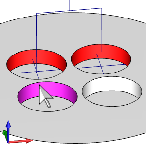

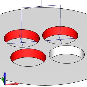

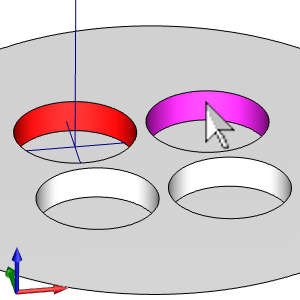

The geometry is added to the Selected Geometry list, and toolpath appears on the selected cylinder. - Select another of the cylindrical surfaces.
The geometry is added to the Selected Geometry list, but notice toolpath doesn't appear on this cylinder.
Since this cycle is for radial patterns, and since this new geometry does not fit into a radial pattern with the other two, it is left without toolpath. - Select the last of the cylindrical surfaces.

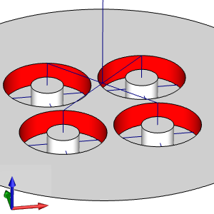

The geometry is added to the Selected Geometry list, and toolpath appears on this, as well as the last, cylinder.
Since the third, and now fourth cylinder fit into the radial pattern of the first two, all toolpath is now added.

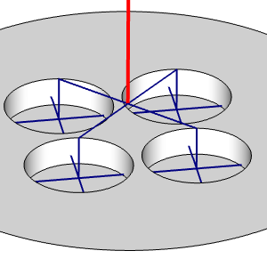

Note: Since our contact points are arranged in a radial pattern, adjusting the X,Y Initial Position will not work.However, we can adjust the Z Axis.

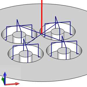

- In the Initial Position group, update the Z value by adding -1.00 to the end of the current value, and press Tab.
Part 6) Updating the Options section

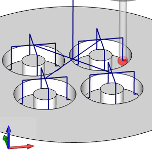

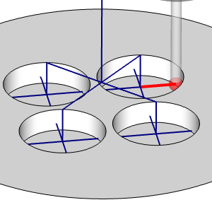

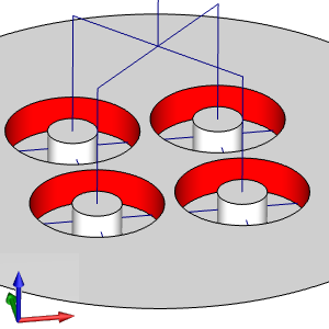

The Options section for this cycle consists of the Radial Clearance value only.This value will allow you to set how far past the surfaces to move before dropping down to the contact depth.
- Click the Options tab.

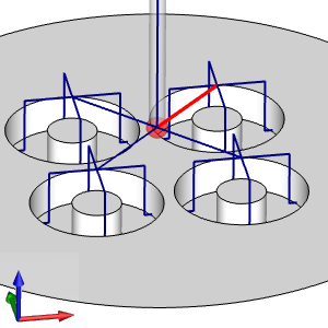

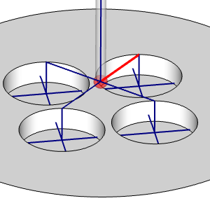

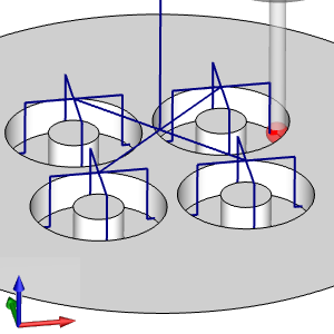

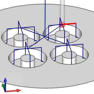

The Backplot dialog launches. - Click Next three times to view the probe movements.
- Notice we seem to have cleared the surface with our probe.Click Next until contact is made with the surface.
Tip: Using a Top View can help you ascertain the clearance of the probe easier.

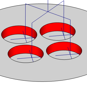

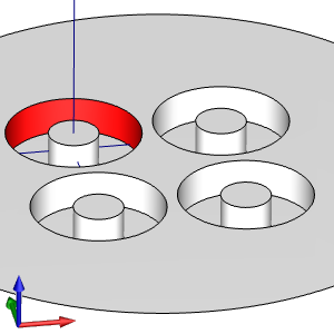

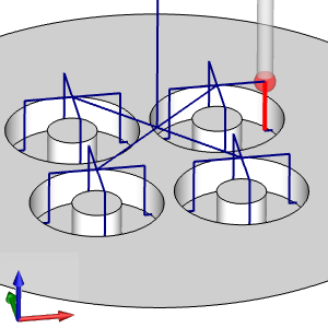

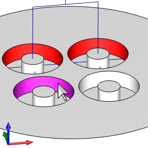

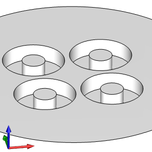

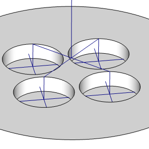

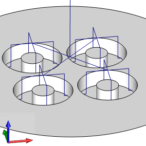

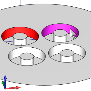

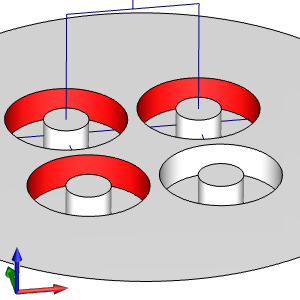

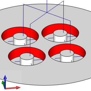

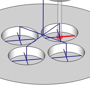

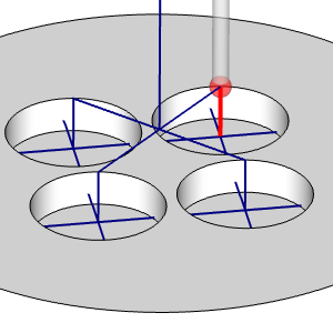

Note: Notice our toolpath is currently going through the obstruction in the middle.This will be handled later in the example.
