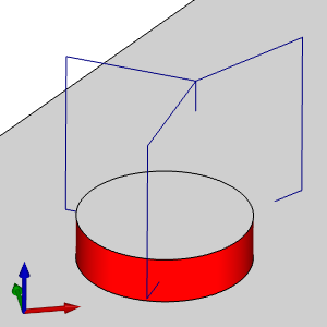

By default the Selected Geometry list is given focus to allow you to select geometry from the graphics area. - Select a cylindrical surface which has been extruded along the Z Axis, or the edge of that surface.
Part 5) Updating the cycle
In this case, the geometry we have chosen could be interpreted as a Boss (4 point) cycle.Since this is not the cycle we intended to use, we will need to update the currently selected cycle.
- At the top of the Cycles section click the drop down list and select Boss (3 point) from the list.

The Parameters section for this cycle consists of the Z Measurement Height, the angles on which the contact points will extend, the Diameter and the Update Work Offset value.In this case we do not really need to adjust the height at which the probe will make contact.The diameter is automatic and should not need to be adjusted, and the Update Work Offset value can be used as needed.In this part, let's just take a look at adjusting some of the angles.
- In the Parameters section, update the Third Angle value to 170 and pressing tab.
The angle is updated, and we now have each contact point separated equally around the boss.

The Backplot dialog launches. - Click Next three times to view the probe movements.
- Notice we seem to have cleared the surface with our probe.Click Next until contact is made with the surface.
