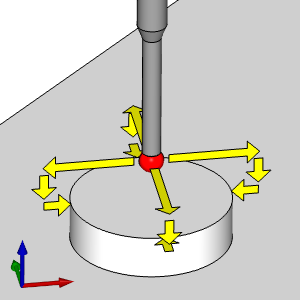

This cycle measures a cylinder extruded in the Z Axis with 4 points.This cycle can utilize the following geometry inputs:
- An arc whose normal is parallel to the Z Axis.
- A cylindrical surface edge whose normal is parallel to the Z Axis.
- A cylindrical surface whose normal is parallel to the Z Axis.
Note: The probe lifts between measurements and the touch points move in towards each other along the X and Y Axes as this cycle is meant to measure extrusions.

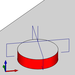

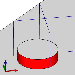

By default the Selected Geometry list is given focus to allow you to select geometry from the graphics area. - Select a cylindrical surface which has been extruded along the Z Axis, or the edge of that surface.
Note: Since our contact points are arranged in a radial pattern, adjusting the X,Y Initial Position will not work.However, we can adjust the Z Axis.

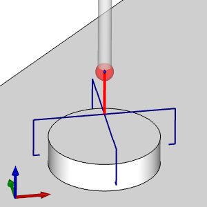

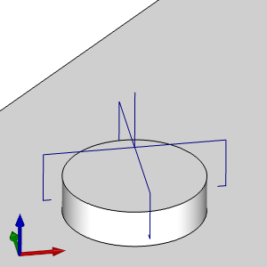

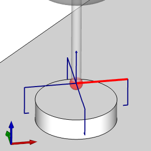

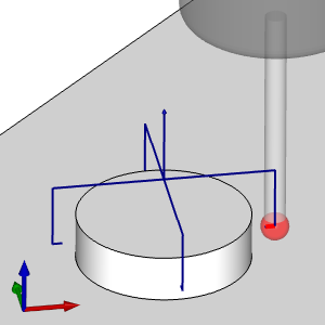

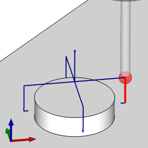

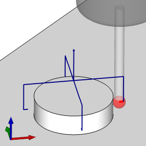

The Backplot dialog launches. - Click Next three times to view the probe movements.
- Notice we seem to have cleared the surface with our probe.Click Next until contact is made with the surface.
- Click Close.
