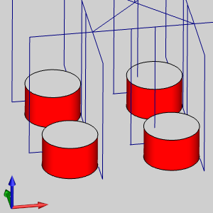

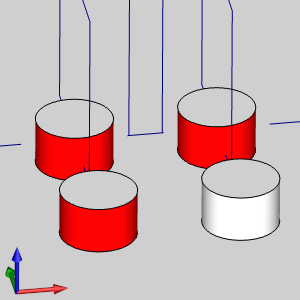

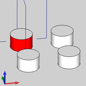

By default the Selected Geometry list is given focus to allow you to select geometry from the graphics area. - Select one of the cylindrical surfaces which has been extruded along the Z Axis, or the edge of that surface.
The geometry is added to the Selected Geometry list, the Initial Position and Parameters section are populated, and the toolpath becomes visible. - Select another of the cylindrical surfaces.

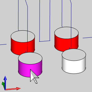

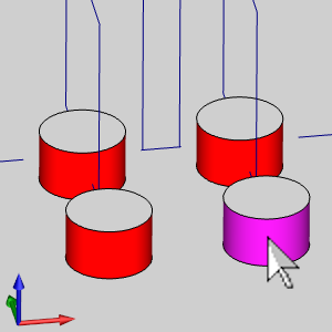

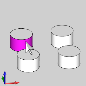

The geometry is added to the Selected Geometry list, and toolpath appears on the selected cylinder. - Select another of the cylindrical surfaces.

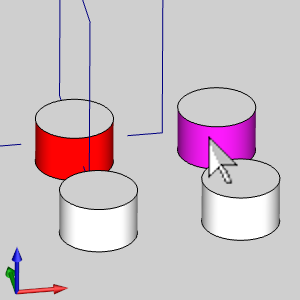

The geometry is added to the Selected Geometry list, but notice toolpath doesn't appear on this cylinder.

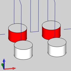

Since this cycle is for radial patterns, and since this new geometry does not fit into a radial pattern with the other two, it is left without toolpath. - Select the last of the cylindrical surfaces.

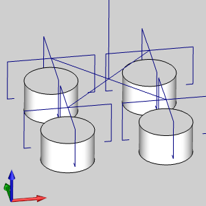

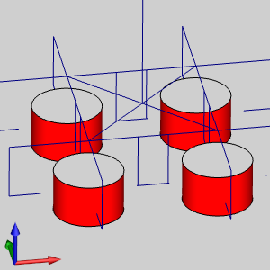

The geometry is added to the Selected Geometry list, and toolpath appears on this, as well as the last, cylinder.
Since the third, and now fourth cylinder fit into the radial pattern of the first two, all toolpath is now added.

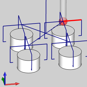

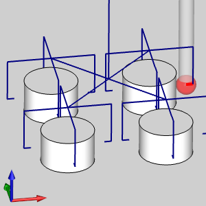

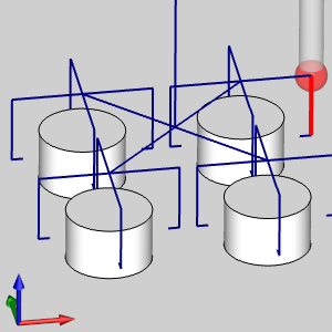

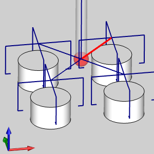

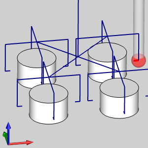

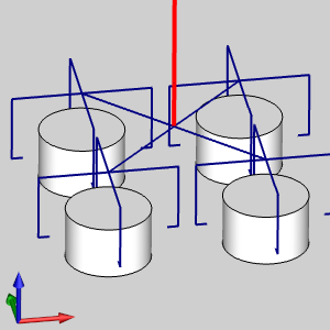

The Backplot dialog launches. - Click Next three times to view the probe movements.
- Notice we seem to have cleared the surface with our probe.Click Next until contact is made with the surface.
Tip: Using a Top View can help you ascertain the clearance of the probe easier.
