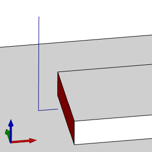

The cycle can be selected with the drop down list under the Cycles section, but simply selecting the appropriate geometry will usually select the required cycle automatically. Since certain geometry could be applicable to several cycles, in some cases, the list will become much smaller. In this case however, there is only one cycle possible for the geometry we choose.
- Click the Parameters tab.

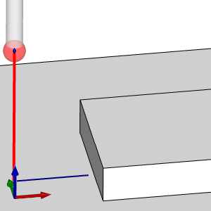

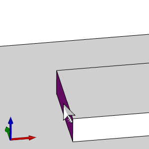

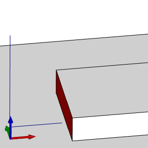

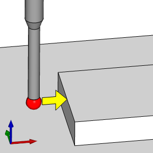

By default the Selected Geometry list is given focus to allow you to select geometry from the graphics area. - Select a planar surface whose normal is parallel with X, or the edge of that surface.

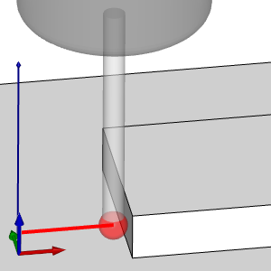

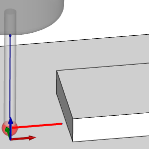

- In the Initial Position group, update the X value by adding -0.5 to the end, and pressing Tab.
The value and the toolpath update to put the initial position of the probe a half inch further back in X. - In the Initial Position group, update the Y value by adding -0.5 to the end, and pressing Tab.
Note: Since our toolpath is shown on the proper side of the surface, we have no need for the Other Side button in this group.

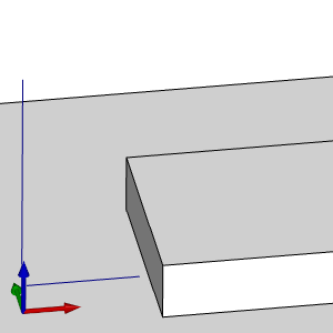

The Backplot dialog launches. - Click Next to view the probe movements.
- Click Close.
