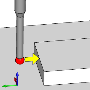

This cycle measures a planar surface face which is parallel to the Y Axis.This cycle can utilize the following geometry inputs:
- Line parallel to the X Axis.
- Planar surface edge parallel to the X Axis.
- Planar surface face whose normal is parallel to the Y Axis.

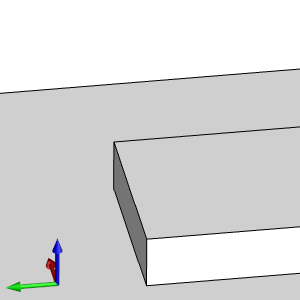

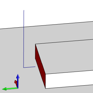

The cycle can be selected with the drop down list under the Cycles section, but simply selecting the appropriate geometry will usually select the required cycle automatically. Since certain geometry could be applicable to several cycles, in some cases, the list will become much smaller. In this case however, there is only one cycle possible for the geometry we choose.
- Click the Parameters tab.

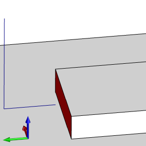

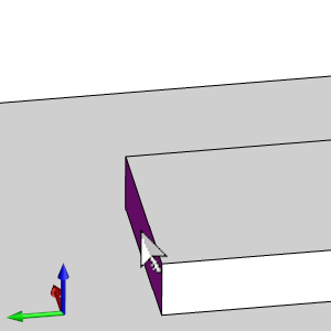

By default the Selected Geometry list is given focus to allow you to select geometry from the graphics area. - Select a planar surface whose normal is parallel with Y, or the edge of that surface.

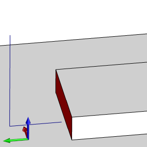

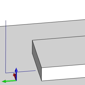

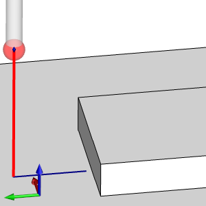

- In the Initial Position group, update the Y value by adding +0.5 to the end, and pressing Tab.
The value and the toolpath update to put the initial position of the probe a half inch further forward in Y. - In the Initial Position group, update the X value by adding -0.5 to the end, and pressing Tab.
The value and the toolpath update to put the initial position of the probe a half inch further down in X.

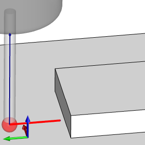

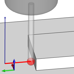

The Backplot dialog launches. - Click Next to view the probe movements.
