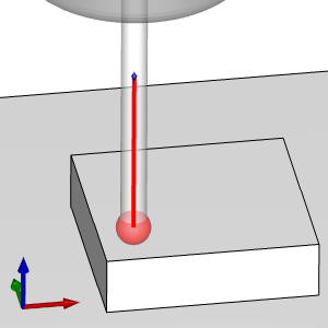

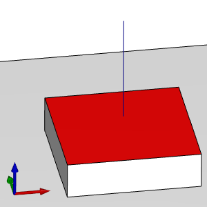

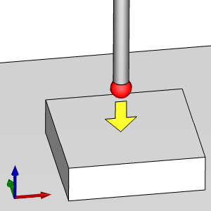

This cycle measures a planar surface face which is parallel to the XY Plane.This cycle can utilize the following geometry inputs:
- Planar surface face whose normal is parallel to the Z Axis.

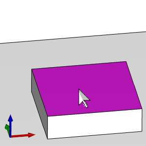

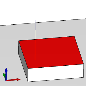

By default the Selected Geometry list is given focus to allow you to select geometry from the graphics area. - Select a planar surface whose normal is parallel with Z.

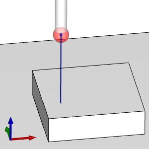

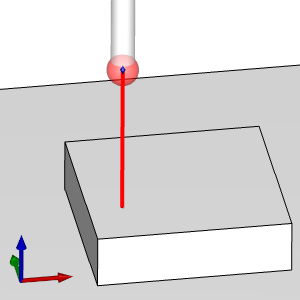

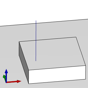

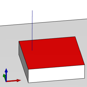

- In the Initial Position group, update the X value by adding -0.5 to the end, and pressing Tab.
The value and the toolpath update to put the initial position of the probe a half inch further back in X. - In the Initial Position group, update the Y value by adding -0.5 to the end, and pressing Tab.
Note: Since our toolpath is shown on the proper side of the surface, we have no need for the Other Side button in this group.
