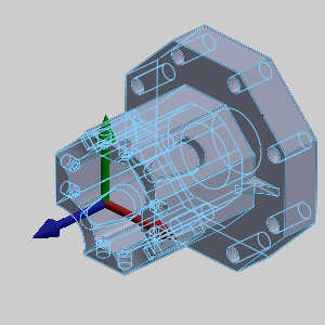

In the example fileprovided, the Tool Crib is already equipped with the necessary tools and the stock and Machine Setup are already defined.The part is simulated using the BC_Hermie_C20U machine.

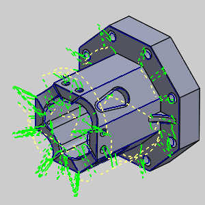

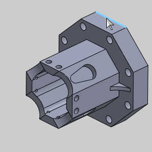

Part 5) Surface paths
  3. Select the model.

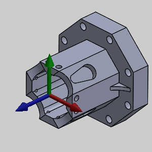

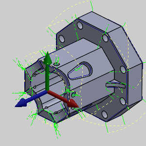

Part 6) Tool axis control
  3. Click Compute.

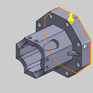

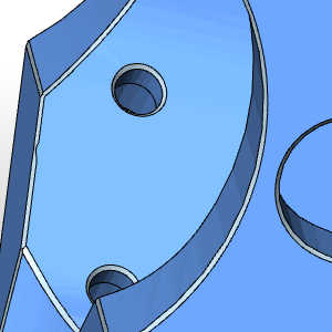

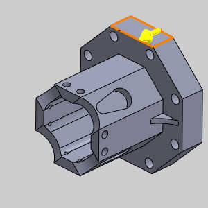

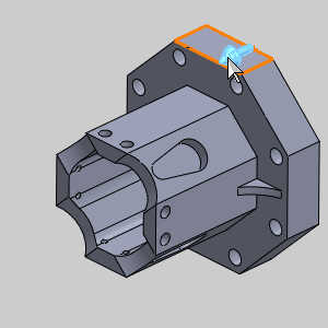

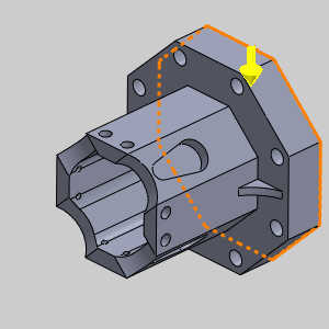

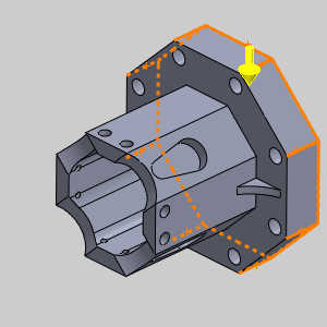

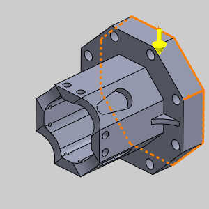

    The Mill Multiaxis Wizard disappears and the Re/Select Geometry dialog opens allowing you to select edges to avoid cutting.
    With the edge highlighted, right-click and select Select Loop.
  5. Click the arrow to flip the loop selection.
  6. Select the edge along the outer diameter of the part as seen in the image below.
  7. Repeat this for the remaining edges.

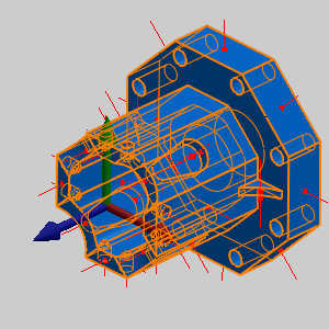

  8. Click OK.
  9. Click Compute.

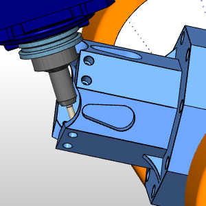

Part 8) Simulation

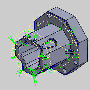

Part 9) Edit the feature
  5. Click Compute.
Part 10) Simulation
