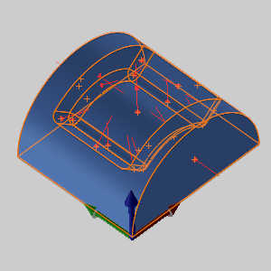

  5. Click the ellipses button next to Floor surfaces.
    The Re/Select Geometry dialog appears.
  6. Select the bottom of the part as seen in the image below.
  7. Click OK.
  8. Click the ellipses button next to Wall surfaces.
  9. Select the walls of the part as seen in the image below.
  10. Click OK.
  11. Click Compute.
