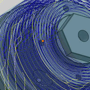

    Notice we are not machining all the way to the back of the stock.
Part 7) Simulation
    Notice at the start of the pass the tool is to the -Y side of the rotation axis.
    At the start of the next pass the tool is to the +Y side of the rotation axis and the chuck is spinning the other way.
    This is done to continue our climb engagement while allowing Bi-directional axial moves.
  3. With Popup Notifications set to Collision & Gouge the simulation will stop to warn of a crash.
    Exit out of the Gouge/Collision dialog.
  4. Set the Stock to Transparent and the Workpiece to Show.
    The arbor is coming into contact with the stock before the final depth is reached.
    We will correct this by limiting the Radial User limits of the Machining area.

    This is clearly not the desired result.
Part 9) Understanding the Radial limits
Important: The radial start begins from the center of rotation.With a Start of zero, and the end at our specified distance we are only doing the last few depths of the part.

    Notice we no longer have a collision, but we now are not machining to the part in the front and back.
    We will complete this last portion with the feature we copied into the CAM Tree.
