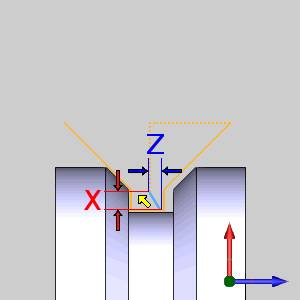

Lead-in
The Lead-in is an additional move prior to the initial cut into the material. The Lead-in allows you to specify how the cut is approached.
- Parallel
- creates a lead into the material that is parallel with the
toolpath move it is preceding.
- Perpendicular
- creates a lead into the material that is perpendicular to
the toolpath move it is preceding.
- Horizontal
- creates a lead into the material that is parallel to the
center of rotation.
- Vertical
the center rotation.
- Angle
- creates a lead into the material that is at a 45 degree angle.
- Custom
- creates a lead into the material that is dictated by the
values entered in the Lead-in Z, and Lead-in X boxes.
- Lead-in
Z - sets the distance and direction of travel, in the Z-axis,
for the approach into the toolpath.

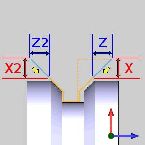

- Lead-in
X - sets the distance and direction of travel, in the X-axis,

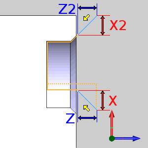

- Lead-in
Override Z2/X2 - When the Force Down Cutting pattern is in use, there are actually two lead-ins to the feature. By default, these values are adjusted so the one side is a mirror of the other. Selecting this option will allow the Lead-in Z2, and Lead-in X2 variables to be adjusted by the user.
- Lead-in Z2 - sets the distance and direction of travel in the Z-axis for the other approach into the toolpath.
- Lead-in X2 - sets the distance and direction of travel, in the X-axis, for the other approach into the toolpath.
