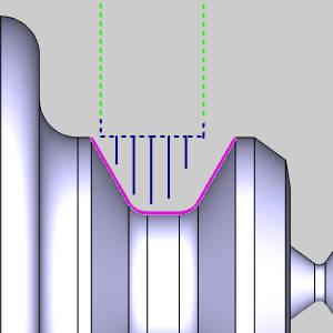

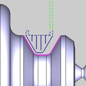

Stepover - sets the spacing between toolpath passes.
Rough Allowance -  Selecting this option will create a pass before the final pass to act as a semi-finish. The spacing of the semi-finish pass will be dictated by the values entered in the Z and X boxes.
Semifinish Pattern - Once a Rough Allowance has been selected, the Semifinish Pattern will allow you to select between a one directional semifinish, or a semifinish that forces a downward cut.
Basic Finish
Force Down Cutting
Force Down Cutting with Overlap
Force Down Cutting - selecting this option will force the semifinish to be cut from each side of the groove one at a time, each in a downward direction, to the middle of the groove. Adding an overlap will set each pass to go past the center of the groove half the specified amount.
Overlap - sets the total distance between the two passes exits, not including any leads that are uses.
Basic Finish - sets the semifinish pass to one single direction.

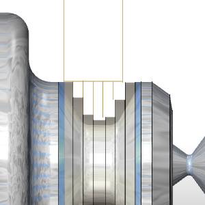

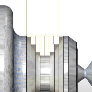

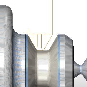

Allowance Examples
No Allowance
Finish Allowance
Rough & Finish
No Allowance Simulation
Finish Allowance Simulation
Rough & Finish  Simulation

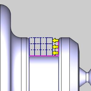

Multiple Depths
The Multiple Depths group allows you to break the total groove depth into steps rather than just one full depth cut or pecked cut.
Depth of Cut - allows you to set the spacing between depth passes.

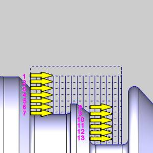

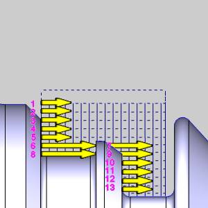

Processing - allows you to handle instances where the selected geometry causes the toolpath to be broken along a number of passes. This will allow you to decide how the tool will move between the separated areas of toolpath.
By Area - will complete all depth passes on whole area before moving to next.
By Level - will cut all areas of the part to the current pass depth before beginning the next.
By Area
By Level

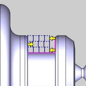

Sorting - allows you to set the operation to be cut in a single direction or a back and for motion.
One Way - forces each pass to be cut in the same direction.
Zig Zag - forces each pass to be cut in opposing direction.
One Way
Zig Zag

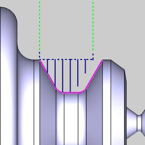

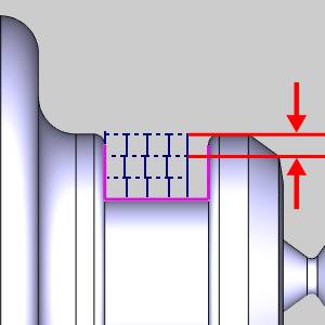

Pecking
Pecking allows you to set incremental depths, clearances and retracts.
  • First Peck Amount - sets the amount of material removed during the first entry into the material.
  • Peck Clearance - sets the height above the material from which the tool speed changes from rapid to feed (for each peck).
  • Peck Increment - sets the amount of material that is removed by each pass performed after the first peck.
  • Peck Retract - sets the distance that the tool retracts between each peck.

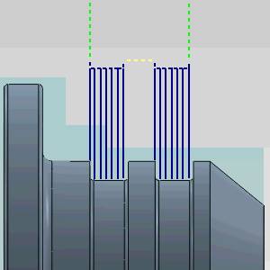

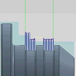

Bounds
Trim to Stock -  With this option cleared, no toolpath will be trimmed.
Trim to Stock - With this option selected, the toolpath extending beyond the Operation Stock will be trimmed.
Trim to Stock off
Trim to Stock on
