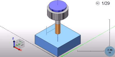

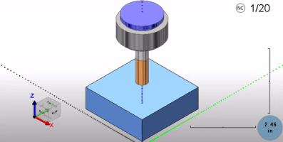

Standard Pocket - creates a pocket with the specified patten. Standard pockets do not support open pockets.
Parallel - creates a pattern of parallel cuts where the tool feeds in both directions. With this pattern, you can select either No Profile, Profile After, or Profile Before, from the Final Contour group.
Offset Pocket Out - creates a pocket pattern which continually offsets the inner shape of the pocket and creates the toolpath from the inside-out.
Offset Pocket In - creates a pocket pattern which continually offsets the outer shape of the pocket and creates the toolpath from the outside-in.

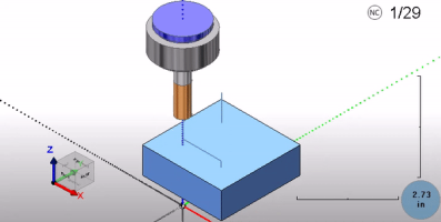

Advanced Pocket - creates a pocket with the specified patten. Advanced pockets are able to support open pockets. See the Open Pocket Example for more information.
Parallel - creates a pattern of parallel cuts where the tool feeds in a single direction. With this pattern, you can select either No Profile, or Profile After, from the Final Contour group.
Offset Pocket In - creates a pocket pattern which continually offsets the outer shape of the pocket and creates the toolpath from the outside-in. This option is different in that the first cut, which is against the wall of the pocket is skipped until the rest of the pocket is cleared out.
Standard Pocket Advanced Pocket Morph Spiral - creates a pocket pattern which combines a spiral and the offset shape of the pocket in order to eliminate linking moves. A morph is only applied in situations creating a closed contour. Open pockets will not always be able to utilize the morph pattern.
Standard Offset Morph Spiral Adaptive Roughing - creates a high-speed machining operation with automatic tool engagement settings. When this option is selected, the Minimal Curvature Radius is added to the Parameters group in this dialog box. In addition, the Link Clearance is added to the Finish group in the Parameters page of the wizard.
Use Spiral for Circular Pockets - Spiral pockets give the user the ability to create spiral toolpath instead of the standard offset toolpath for circular pockets.
Select the check box to a override the previously selected pattern in favor of a spiral pocketing method on circular pockets.
While the check box remains unselected, the currently selected pattern will be applied to all geometry, including circles.
