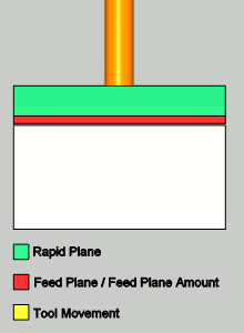

    • Peck - From the Feed Plane, Peck will move at the Plunge Feedrate to the Peck Depth, return to the Feed Plane with a rapid move, rapid down to a point above the last depth equal to the amount of the Feed Plane being used, before continuing to the next Peck Depth amount at the Plunge Feedrate. This method will be repeated until the full Depth of Cut is reached.
      • Peck Depth - sets the increment to use for each peck.
    • Fast Peck - From the Feed Plane, Peck will move at the Plunge Feedrate to the Peck Depth, Rapid up to an amount equal the Feed Plane being used, before continuing to the next Peck Depth amount at the Plunge Feedrate. This method will be repeated until the full Depth of Cut is reached.
