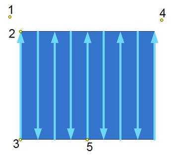

  • The first scenario shows an open surface contour with parallel cuts.
  • The default start point is defined by the toolpath pattern. The image shows that the Cutting Method is set to Zig Zag and the machining starts at position 3 by default.
  • If a new start point is set at position 5 then the machining starts from the initial start point (position 3). The new start point cannot change the order of the cuts. So the machining won't start from the middle.
  • If a new start point is set at position 1, 2, or 4 then the starting point for the machining is position 2. The machining now swaps and starts from the opposite side. Again, a new start point doesn't change the cut order, just the start position on the initial surface edge.

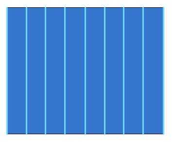

  • The next scenario shows the same surface but this time the Cutting Method is set to One Way. In this case it doesn't matter which start point is selected, the start point is always at position 3.

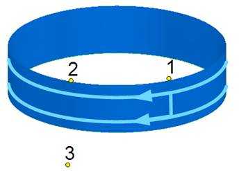

  • The next scenario shows a closed surface contour with parallel constant Z-cuts. The cuts are closed contours so that means that the cuts end where they started.
  • The Cutting Method is set to One Way. The standard start point would be at position 1.
  • Now the new start point is set to position 2. Accordingly, the start point moves to position 2.
  • If the new start point is set to position 3 then machining starts at position 2. The reason is the same as before, when the start point is changed only the start position on the initial start edge changes, not the cut order.

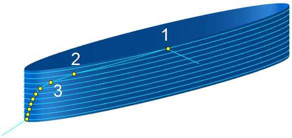

  • The second scenario shows a closed contour with constant Z-cuts using One Way. Rotated By[Deg] is set to five degrees. In this case the start point is rotated five degrees at every complete rotation.
  • Every new start point position is calculated based on the surface normal direction. That means that in the area where the surface radius is large, the start points are spread (position 1, 2, and 3). In the area where the surface radius become smaller, the surface normal direction becomes bigger, so the start point positions are much closer to each other.

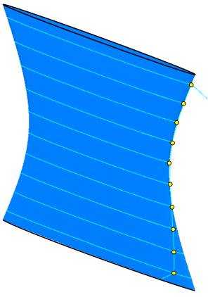

This option is used for blisk blades or turbine blades machining. In this case it is desired to have a start point at the small radius of the wing. Unfortunately the start points move by themselves and leave the edge position. To avoid this they can be forced to be always at a position with the same surface normal direction. In this way the start points always stay at the edge.
  • The new start point was picked in the upper left corner. The resulting toolpath with a new start point appears as shown next. In the lower section the toolpath start points are moving away from the edge into the wall face.

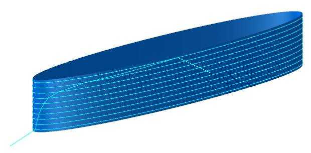

  • With Minimize Surface Normal Change activated the start point stays at the point with the same surface normal direction, which means on the edge of the wing.
