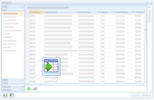

Importing a Library
To use an existing library:
  1. Click the Import from file button on the bottom left.
    The Open dialog appears.
  2. Locate and highlight the appropriate file.
  3. Click Open.
    The library is updated based on the imported file.
