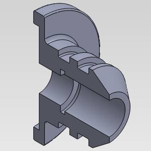

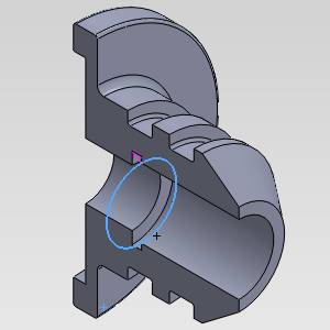

Important: The wireframe geometry is flat in the X/Y plane and in the X-/Y+ quadrant. When creating a Turning Job, this is the quadrant in which your geometry should be located.
  1. Open the Lathe_Basics_Tutorial.sldpt file.
  2. Click the CAMTree - Manager tab to access the CAM Tree.
  4. Under Job
  5. Type, select Turningand clickselect the Start

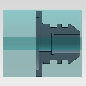

The first page of theStock Wizard allows you to define a Workpiece for the Turning Job and the subsequent pages handle shape, size and clearances. In this example, we will not define a Workpiece, but will define the shape, size and clearances for our stock. Once the stock has been defined you can adjust the visibility of the stock.
  2. In the Stock Type page, leave the selection on Cylindrical and click insideof the StockCoordinate System.
  3. Select CoordinateSystem 1 from the Flyout Feature Manager Design Tree.
    The Stock is now associated with Coordinate System 1.
  4. In the Size group, type in the following values:
    1. Stock Diameter = 5.125
    2. Internal Diameter = 1.000
    3. Length = 6.000
    4. Stock Origin = 0.125
  5. Click .
  6. Select CoordinateSystem 1 from the Flyout Feature Manager Design Tree.
    The Machine Setup is now associated with Coordinate System 1.
  7. Leave the Clearance values as they are and click OKto finalize the stock and exit the wizard.
  8. In the CAMTree tab in the BobCAM  CAM Tree, right-click Stockand select either Transparencyor Blank.These choices will allow you to, either adjust the transparency of the stock or blank it out completely.
Higher Transparency
Blank

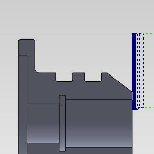

Part 3) Facing the Part
For most every Turning Job,you will need to face off the stock. By selecting a Lathe End Face feature, we will automatically create toolpath up to the machine zero without the need to select geometry. The only time geometry will need to be selected for the Lathe End Face feature is if the desired toolpath needs to endbefore, or, continue beyond the machine zero.
Add the Feature
  1. In the CAM Tree, right-click Machine Setup - 1 and selectLathe End Face.
    The Lathe End Face feature launches with the Geometry Selection pageactive. Since our target geometry is already at the machine zero, we do not need to select geometry.
  2. Click Next>>to continue to the Feature page.
Create Feature Extensions
  1. Select the Extensioncheck box and, in the End Distancebox, enter a value of 0.1000.
Select a Tool
  1. Click ToolCrib at the top of the Lathe Wizard.
    The Tool Crib launches.
  2. Click ROUGH to select the insert type, and then click Add From ToolLibrary.
    The Tool Library launches.
  3. Select tool number 263to highlight the CNMG- 3/64RAD - ROUGH TURNINGtool.
  4. Click OKto exit the Tool Library and return to the Tool Crib.
  5. Click OKto exit the Tool Crib and return to the Lathe Wizard.
  6. Select Parameters.
Adjust Parameters and Compute
  1. Select the RoughAllowance check box.
Tip: In this case, we use our roughing tool to rough and finish the face. Since we use the same tool for the rough and finish, the need to create a separatefinish operation is avoided by utilizing the Rough Allowance. The RoughAllowance ceases the roughing operation at the values entered and creates an additional semifinish pass up to the Finish Allowance specified next.
  1. In the Finish Allowancegroup, change both the Z and, X value to 0.0000.

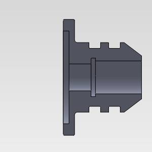

Blank Toolpath
  1. So that we can focus on one toolpath at a time, right-click the new FeatureLathe End Face in the CAM Tree and select Blank/UnblankToolpath to hide the toolpath.

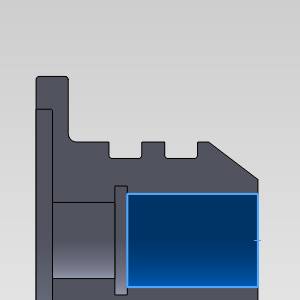

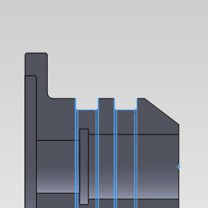

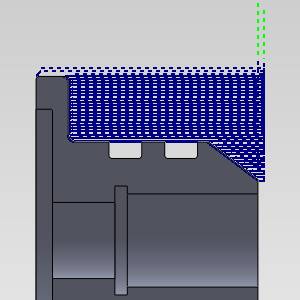

Part 5) Grooving the OD
In this case, we have two grooves that need to be completed on the ODof the part and one groove on the ID.Right now we will focus on the twoOD grooves.
  1. Right-click MachineSetup - 1 in the CAM Tree and selectLathe Groove.
    The Lathe Wizard launches.
  2. Click SelectGeometry.
  3. In the graphics area:
    1. Click OK.
  1. Click Next>>to continue to the Feature page.
  1. In the Feature page, under the Constraintssection, select From Geometry.
  2. Select Groove.

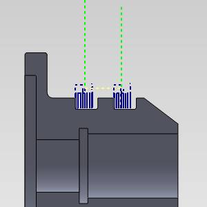

  3. Click ToolCrib.
  4. Click GROOVE and then click AddFrom Tool Library to enter into the Tool Library.
    The Tool Library Launches.
  5. Select tool number 281to highlight the 1/8 WIDE - 1/64RAD- OD GROOVE tool.
  6. Click OK.
  8. Select Patterns.
  1. Select CenterOut under Sorting and click Next>> to continue to the Parameters page.
  2. Select the check box for RoughAllowance and adjust the Xvalue to 0.0050.
  3. Under SemifinishPattern, set the Overlapvalue to 0.0050 to ensure that each of the downward semifinish cuts will go slightly beyond center.
  4. Set the FinishAllowance values to 0.0000.
  5. Click Compute.
  1. Right-click the new FeatureLathe Groove in the CAM Tree and select Blank/UnblankToolpath.

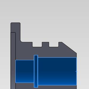

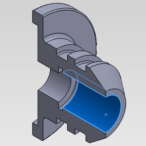

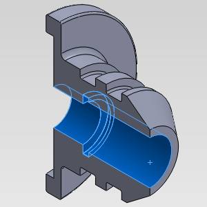

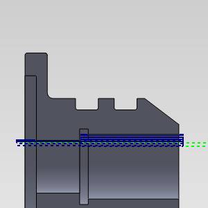

Part 6) Boring the ID
  1. Right-click Machine Setup - 1 in the CAM Tree and select LatheTurning.
    1. Press confirm the geometry selection.
Set Feature Settings
  1. In the Feature page under MaterialApproach, set the Rapid Planeto 0.0500.
  2. Under FeatureParameters, select IDfrom the Feature Type list to set the orientation of the feature.
  3. Under Undercut,select the Remove Primary Undercutcheck box so that our rough does not try to complete the ID groove feature.
  4. Select the check box for Extensionand enter a value of 0.4500into the End Distance box.
  5. Select Rough.
Select a Tool
  1. Click ToolCrib.
  3. Select tool number 500to highlight the CNMG- 1/32 RAD .750 BORING BARtool.
  5. In the Tool Crib:
    2. In order to have this tool orientated properly, select under MountingOrientation.
  1. In the Parameters page, select the checkbox for Rough Allowance and adjust the Z value to 0.0010.
  2. Set both FinishAllowance values to 0.0000.
Tip: In this case, our stock has already been faced off. In order to avoid unnecessary feed movement, we use the Trim to Stock option to set trim the toolpath to the Operation Stock.
  1. Select Leads.
  2. Click Compute.
Blank the Toolpath
  1. Right-click the new FeatureLathe Turning in the CAM Tree and select Blank/UnblankToolpath.

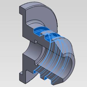

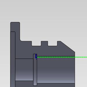

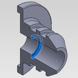

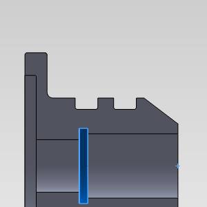

Part 7) Grooving the ID
  1. Right-click Machine Setup - 1 in the CAM Tree and select LatheGroove.

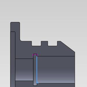

  1. In the Feature page, under MaterialApproach, set the Rapid Planeto 0.0500.
  2. Under FeatureParameters select ID from the Feature Type list.
  3. Under Constraints,select Custom and then clickPick since the material has already been removed for a portion of this geometry, we can change where the toolpath begins.
  4. Highlight the
  5. top edge of the smaller wall of the groove, connecting entity to the right of the groove, and left-click.
  6. Confirm the geometry selection.
    The Lathe Wizard returns.
  7. Select Groove.
Select a Tool
  1. Click ToolCrib.
  2. Click GROOVE and then click AddFrom Tool Library.
  3. Select tool number 280to highlight the 1/8 WIDE - 1/64RAD- ID GROOVE tool.
    In the Tool Crib:
    2. Click OK.
  5. Select Parameters.
Set Parameters and Compute
  1. Select the check box for RoughAllowance and adjust the Xvalue to 0.0500.
  3. Click Compute.
Blank Toolpath

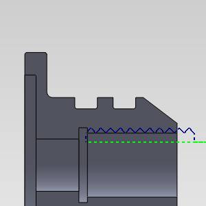

  1. Right-click Machine Setup - 1 in the CAM Tree and select LatheThread.
  1. In the Feature page, under FeatureParameters select IDfrom the Feature Type list.
    1. In the StartDistance box enter a value of 0.3750.
    2. In the EndDistance box enter a value of 0.0300.
  3. Select Thread.
Select a Tool
  1. Click ToolCrib.
  3. Select tool number 505to highlight the 60 DEG - LAY DOWN - ID THREAD .IC  tool.
  4. click OK.
    2. Click OK.
  1. Under Parameters,set Threads Per Unit to 5.0000.
  2. Select the check box for Overrideand set Thread Height to 0.1190.
Important: The ThreadHeight that is calculated in BobCAD-CAM is the theoretical sharp height. Depending on the thread being cut, you may need to adjust this value.
  1. Click Compute.

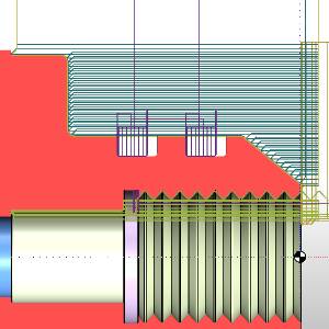

Part 9) Simulation
Open and Close Simulation
  1. In the Modulesmenu, click Simulation.
For help with simulation, view GettingStarted with Simulation.
Tip: The Simulation contains a CutSim tab.Clicking on the Advanced Properties button will launch the Parameters dialog box allowing you to select the Enable checkbox in the Section plane group.This will put the stock in the section plane view seen in the image above.Leave the values as they are and click OK.
