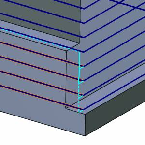

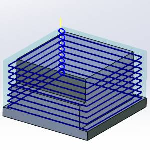

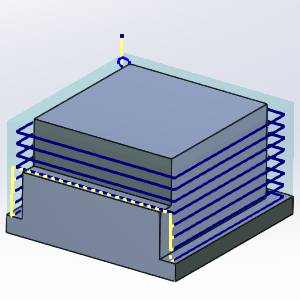

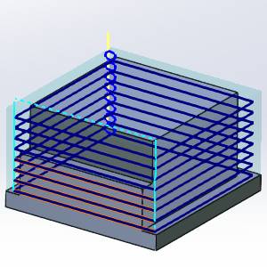

On our example part, we need to remove stock to a uniform depth on three of our four walls. The last wall only needs the top half of the stock removed. Take a moment to notice how the last four passes cut into themodel.It is the last segments of the last four passes that we will need to remove.
  1. In the Property Manager, click the CAMTree tab.
    Notice the shorter depth of the wall on the left.

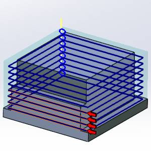

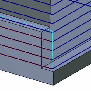

Now, we need to select the toolpath segments intersecting the solidmodel that we want to delete, and the lead-out moves they are connected to.
  1. In the graphics area, select the toolpath elements highlighted  in the image below.

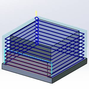

    With the toolpath segments selected, the preview is shown.

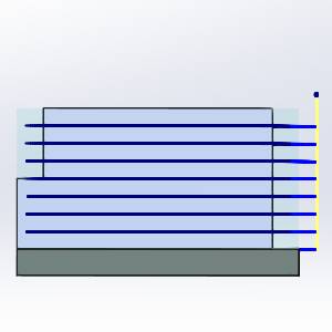

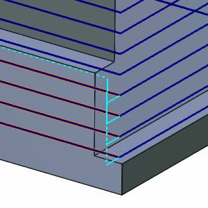

With the toolpath elements selected, we will need to set the Parameters to define how to link between the entities that still exist, since we are removing some of the toolpath. We can just leave the defaults and have the tool move to the rapid plane of the feature, but let's adjust it to stay a little lower and save some time. Be very cautions when makingrapid moves occur around the part.
  1. In the Parametersgroup, change the Retractoption to Custom.
  2. Enter -0.95for the Rapid Plane value.
    The preview updates showing the new retract height.
Note: When the Absolute or Incremental toggle is left at the default Absolute setting, the Rapid Plane value uses the Machine Setup as zero. As such, any heightbelow the machine setup will be a negative value.

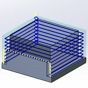

  1. Select the Extensioncheck box.
    The Preview updates.
    Extension Extension
  2. Enter 25 for the Extension value.
    Extension 50% Extension 25%

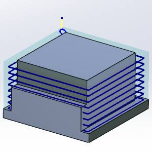

To move beyond the preview, and before clicking OK to finalize and exit,it is a good idea to Execute the current settings. Although clicking OK will Execute and exit simultaneously, using Execute will allow you to use Animation to verify the results and Undo the executed command if and adjustments necessary.
  1. Click Execute.
Part 7) Viewing the Animation
  2. Use the Animation controls to play through the animation.
  1. Click OK.
