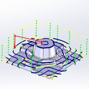

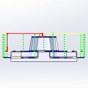

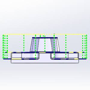

On our example part, we have used a solid model to set the stock to a specific shape. In this case, we have roughed out the stock with an Advanced Rough and have finished that up with a Flatlands toolpath. It is the rapid heights of the Flatlands toolpath we intend to adjust. Take a moment to notice there is only two rapids, highlighted in red in the images below, that need to be at their current height.
  1. In the CAM Tree, click the  Flatlands operation of the Feature3 Axis to highlight the toolpath in the graphics area.
    Take a moment to look at the existing stock compared to the existingtoolpath to see what we intend to accomplish.
    Notice most of these rapid moves could be lower to save some machiningtime.

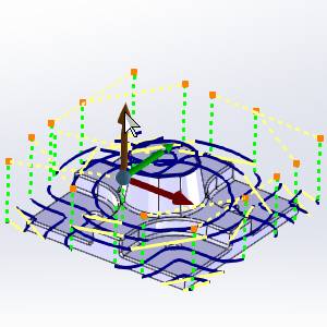

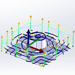

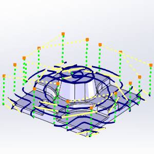

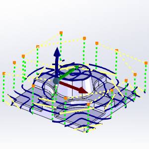

We now, need to select the Point Pick check box under the Selected Toolpath Elements list so that we can pick the points where the vertical and horizontalrapids meet. Once this is selected, we will move and rotate the part, as needed, to pick all sixteen toolpath points shown in the images below.
  1. Under the Selected Toolpath Elements list, select the PointPick check box.
    This will allow us to pick the point at which two toolpath elements meet, thereby giving us the ability to adjust both elements, rather than just one element or the other.
  2. In the graphics area, select the toolpath points shown in the image below.
    In each of the four corners of the part, there are two rapids. Be sure to pick both points on each of the eight rapid moves.

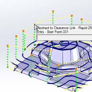

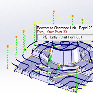

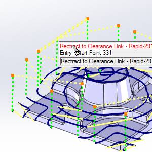

Note: When toolpath elements are close enough together, attempting to select one may cause a dialog to appear. This dialog will allow you to select, from the dialog list, the intended toolpath element, as seen in the images below.

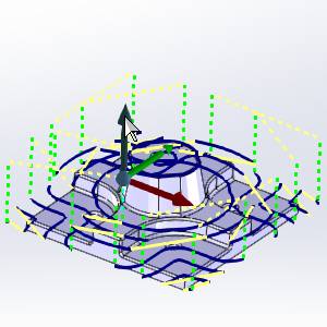

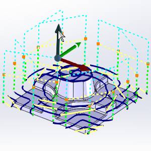

  1. In the Parametersgroup, select the Drag option.
Note: The Drag option will allow you to enter X, Y, and Z values in the Delta group to set the distance the selected toolpath is moved. While the Drag option is the default option, clicking the option will cause the drag handles for the axes to appear. These allow you to move the toolpath manually instead of, or in combination with, data entry using the Delta group text fields.
The drag handles appear in the graphics area.
  1. Hover over the Z Axis of the Drag Handle.
    The Z Axis highlights.
    Click the Z Axisof the Drag Handle.
    The Delta group values become unavailable.
  2. With the Z Axis highlighted, move your mouse up and down and notice the preview adjust.

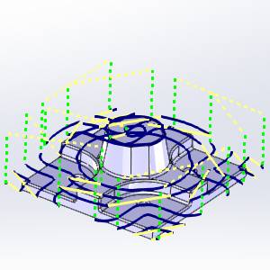

    While the X,Y, and Z values can be adjusted visually, we will enter a value in the Delta Z text field.
    Click in the graphics area to set the toolpath wherever it may be.
    The Delta values become available again.

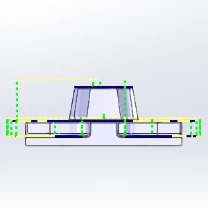

  3. In the Delta Z text field, enter -1.0.

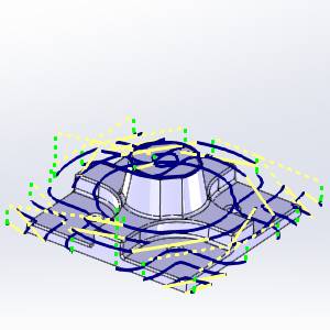

Part 6) Executing the Action

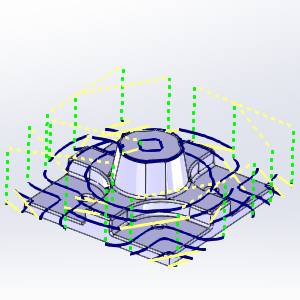

To move beyond the preview, and before clicking OK to finalize and exit,it is a good idea to Execute the current settings. Although clicking OK will Execute and exit simultaneously, using Execute will allow you to use Animation to verify the results and Undo the executed command if and adjustments necessary.
  1. Click Execute.
Part 7) Viewing the Animation
  2. Use the Animation controls to play through the animation. With either the (Solid), (Transparent), or (Wireframe)view.
  1. Click OK.
